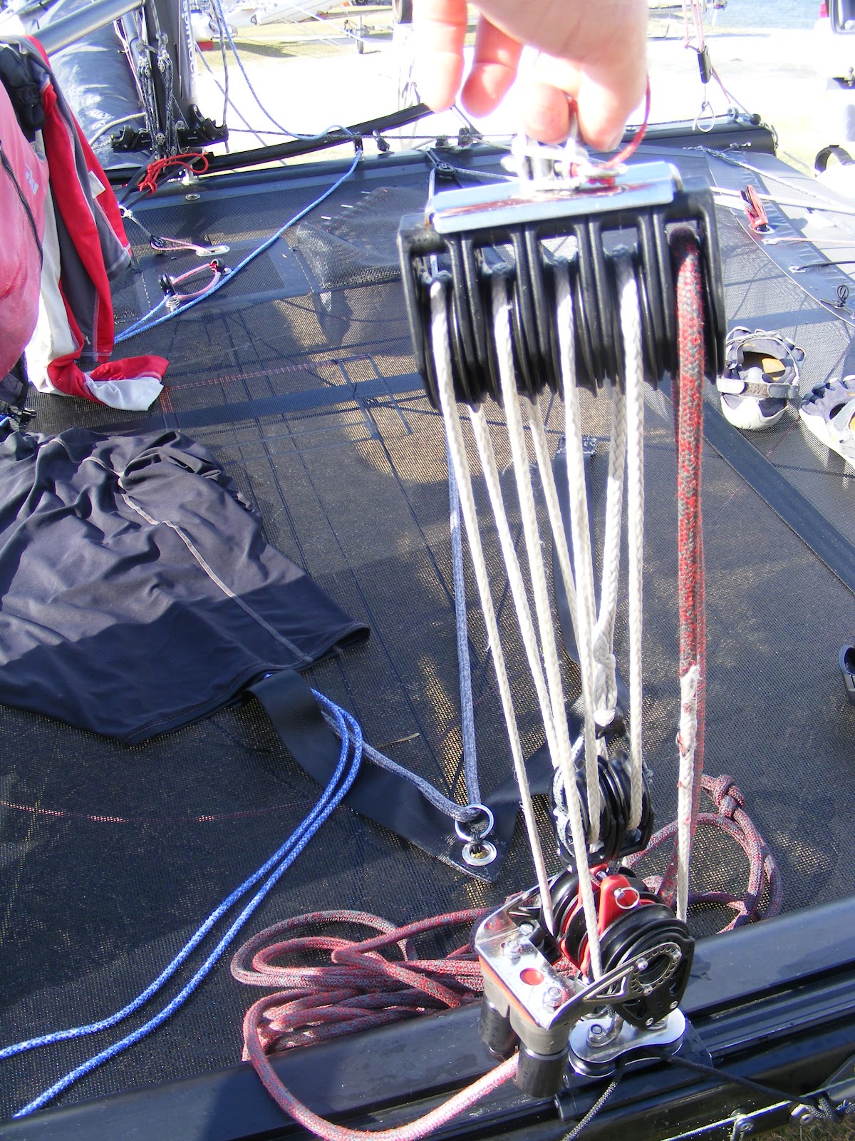

You can knitte 10mm (3/8) line with 6 or 8mm thin line. Like this http://3.bp.blogspot.com/-2Ql_S8taww8/T ... CF7844.JPG |
