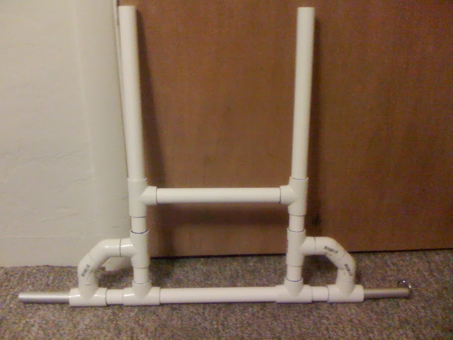

Hi everyone. First, I want to thank the folks who posted their DYI cart designs, which inspired me to do the same. I too was thinking about getting a Pro Angler but I was surprised of the price of the Hobie cart. Buying four tires for my car was cheaper. I went ahead and purchase the 3/4" axle from wheeleez since it fits inside 3/4" PVC pipe without a need for a bushing or reducer. At 28.5" in length, I was going to cut the length but the current design (for 26 cm Foam "Tuff Tire" Wheels) will allow me to still reuse the axle if ever I wanted 30 cm wheels later. Thank goodness PVC is fairly cheap.
I made the mistake of buying Hobie's Post Collar Clamp which is too small for 3/4" PVC. I'm still working on a fix but feel free to post any suggestions. Any input will be greatly appreciated for this work in progress.
Thnx in advance

Figure out exactly where you want the PA to sit on that cart so it clears your wheels. Then get two cross tees for the 3/4 pvc pipe. Cut the PVC pipe to accept the cross tees with the cross pointing fore and aft on each side. Now when you put the pipe up into the scuppers the cross tees will catch in the hollows and stop the downward movement of the PA without putting a cross bar in contact with the rounded bottom which will dent it.
