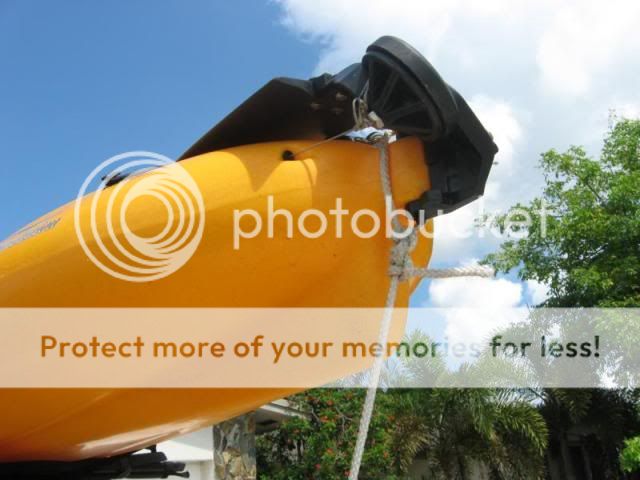

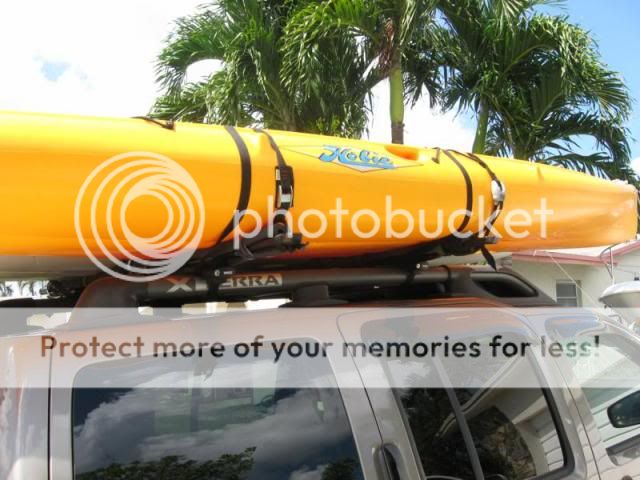

I transport my hobie revolutions right side up due to Ram ball mounts prevent sliding it up onto my roof rack upside down. I slip a bow line throught the padeye and tie a knot forming a loop then down to the bumper tow hook.
The rear I slip my stern line up and over the extended rudder pivot pin part of the stern and between the steering lines and the hull and tie off then down to my trailer hitch or bumper.
The bow and stern lines are not primary and only prevent forward or back shifting during transport as well as to keep the kayak from rotating on the rack. The strap tie downs are the primary method of securing the kayak.
When I transport both revo's my bow and stern lines go from kayak to bumper then back up to the other kayak.

Hi Angel-Rose,
As promised here are the pictures of my rooftop shuttle and how I tie down bow and stern.
I hope this illustrates it well enough.

Thanks Revo!
Looks great. I will probably need to use 2 sets of fore and aft tiedowns, my boats are so much different in length.
2 more questions :
Do you have any problem with hull deformation hauling rails up?
Also-- did you get extended bars for your factory rack? Suggested brand or type? Looks like Thule, and that they just clamp onto your existing rack. True?

Angel-Rose,
You do need to exercise care in how tight you strap down the kayak rails up. My first few times I was over cautious and straped a bit tight where it did deform the hull a bit but the hull has short memory so it was back to normal in no time. I strap them only tight enough to be held in place once the hull squishes a bit I stop and back off. Even rails down you can overtighten the straps and deform the hull. Alternatively you can skoot the kayaks up onto the rack rails up and then flip it over before strapping.
Yes it is Thule Towers and bars. The bars are 65", a standard size from Thule.
I use 1" dia. pipe insulation secured with velcro straps (4 each bar). I will dress it up with real pads one day. This was the inexpensive route. The Thule Tower just clamps on the factory rack and Thule offers Towers for all makes of factory racks. I recommend getting the tower locks too since the racks are pricey at about $160.00 for towers and another $60.00+ for bars.
