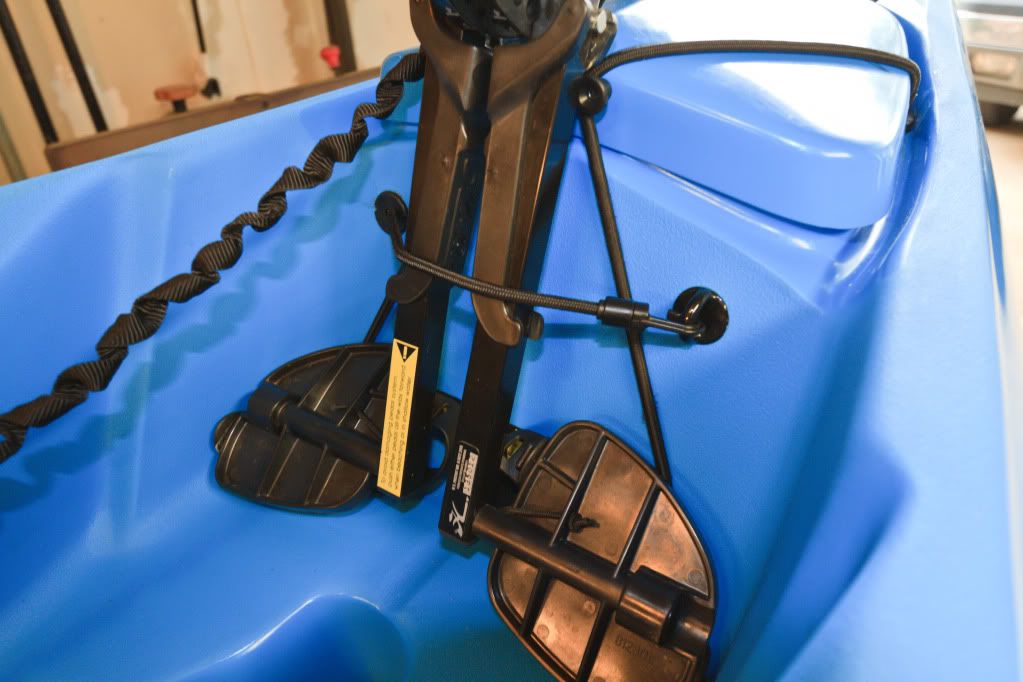

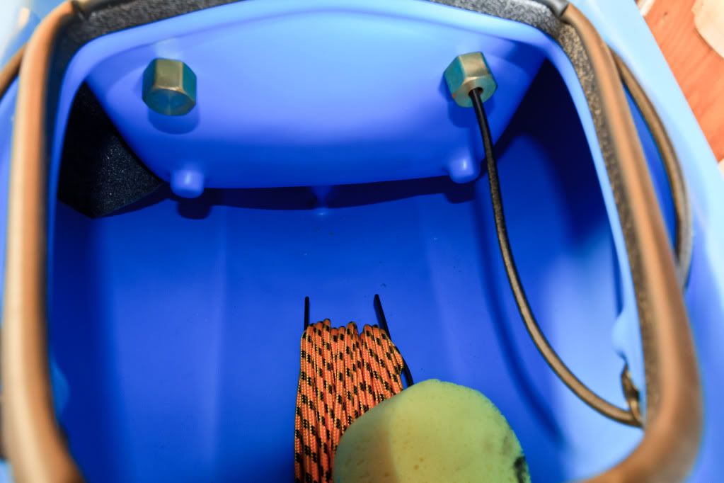

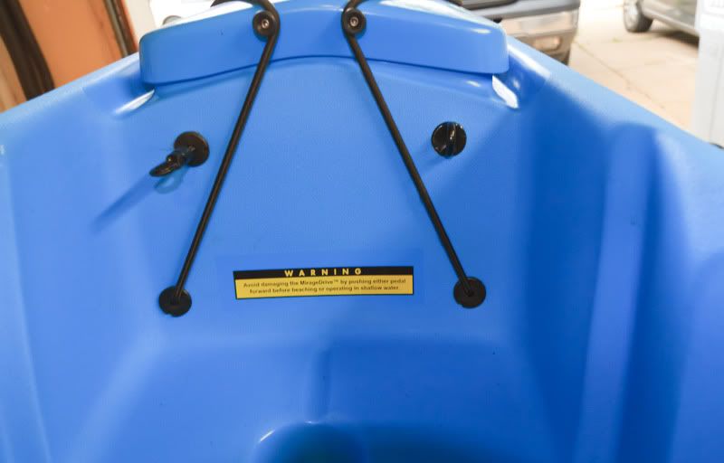

Well I just went ahead and bought the factory shock cord grommets and pad eyes and went to home depot and found that they were standard (or not so standard) 3/4 garden hose thread, so i bought some brass cap ends and used them as nuts. They work great and now have a self retracting shock cord and eye on the front bulkhead to tie down the Mirage drive.
Really cant explain them well enough for anyone to get a real idea of what I'm talking about unless you have seen a Skeeter bass boat rod tie down, only a picture will do but since this site doesn’t have the capability of direct downloading I will never be able to post any pictures.

Found a free picture hosting site so I can finally post pictures of the retractable bungee cord added to the bow bulkhead.

PostPosted: Sat Apr 30, 2011 12:03 pm
Looks great! very clean installation. It's nice to know that those fittings can be used in through-hull applications. 8)
