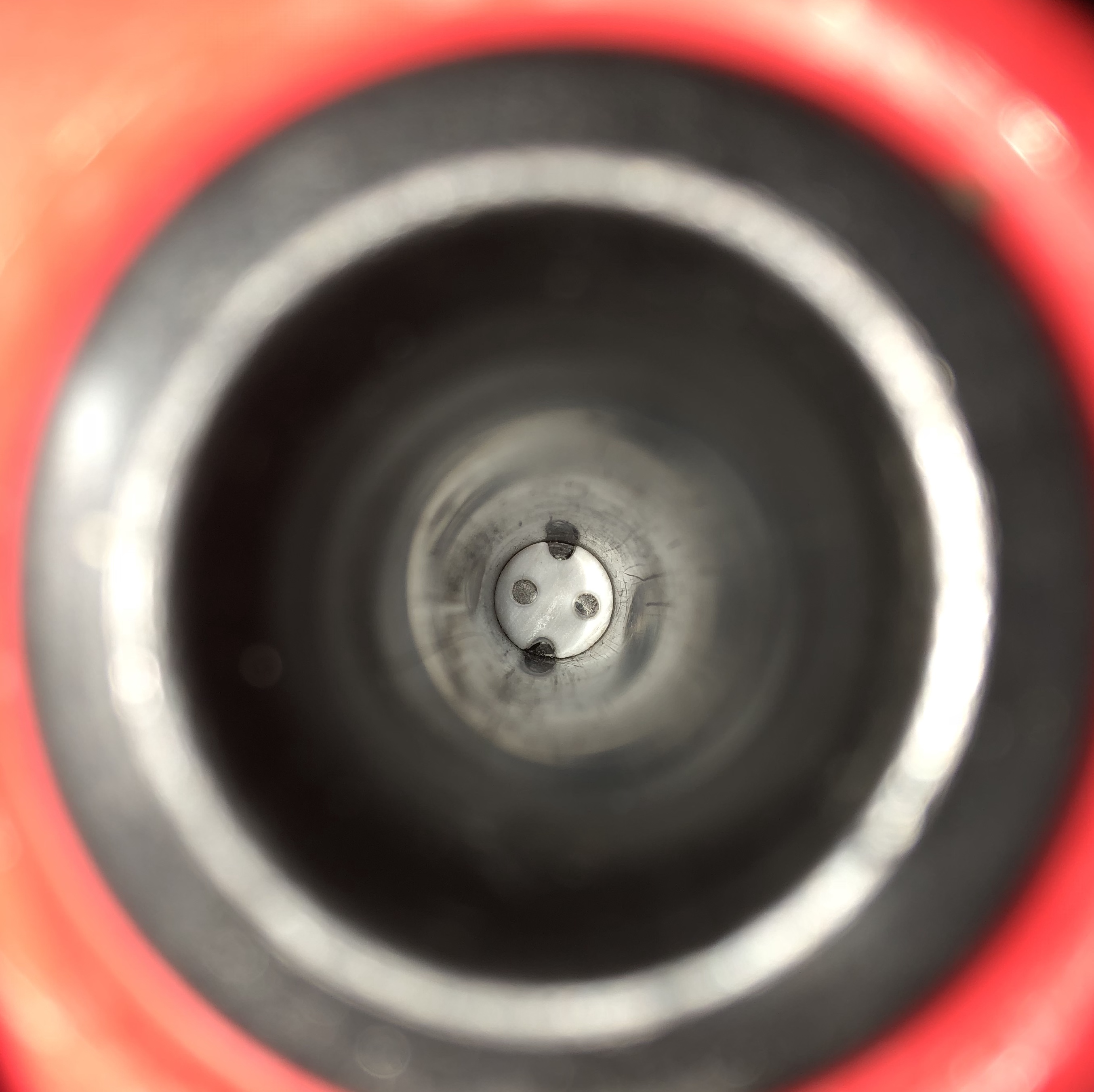

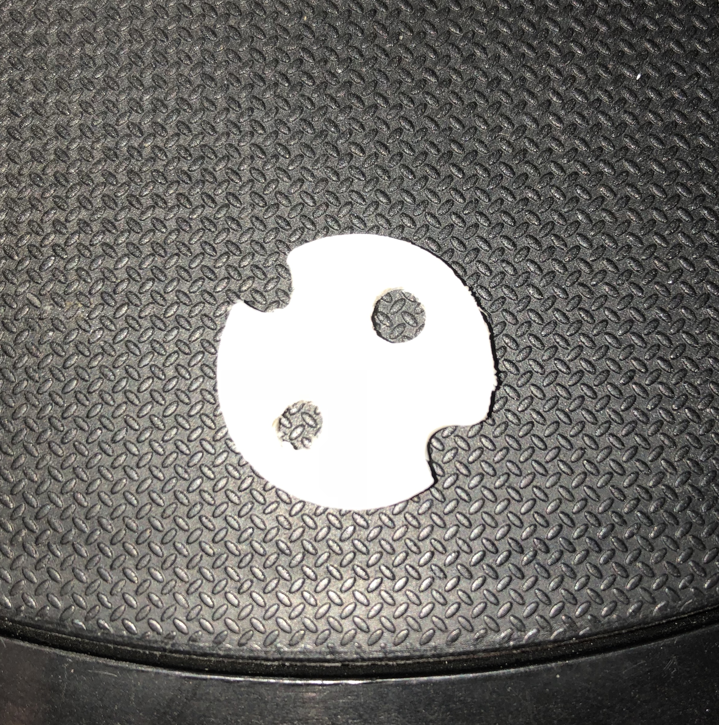

I fashioned a mast slider from 7/8 inch ptfe rod to reduce friction between the sail mast and receiver base on my Oasis when furling and unfurling the sail. I also added some strategically placed holes and notches in the slider to trap grit and such.
When I went to clean the mast receiver to insert the slider I noticed this.
It looked like a protrusion upward at first which would render my slider making a waste of time. But experimentation with various probes revealed this to be a channel groove below the base, not sure its purpose. But all good, and a place for the grit to end up once trapped!
And here is the final result. I also use teflon dry lube on the mast to reduce friction on the sides.

Was on the water Saturday with 7-10 mph winds running coastal river switchbacks with the tide. Ten miles down, 10 miles up. The straights between the turns had the wind either dead ahead or dead astern on each leg so I furled or unfurled on every turn. The combination of the Teflon slider in the mast receiver, Teflon lube on the mast, and pulleys at the turns and the far end of the furling line worked great for low effort quick furling and unfurling. The only place I had some binding was between the mast furling assembly and the piece that holds the mast hold-down cord and clip to attach to the kayak hull. I didn't take a look yet to see why that was binding but suspect I need some Teflon lube there too. Never had that bind before but also suspect I never turned the mast this fast before.
