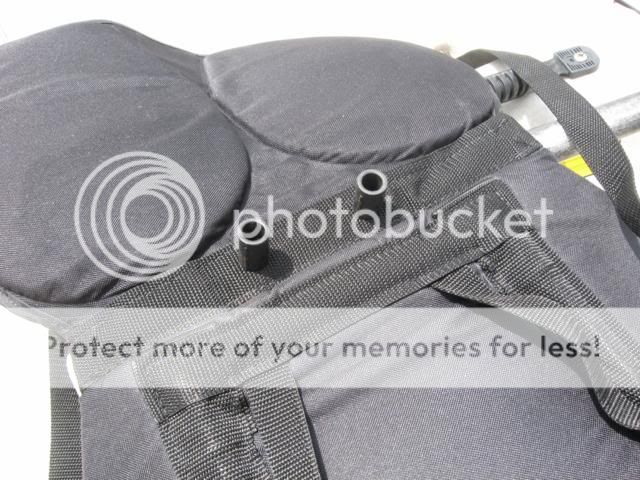

Ok I just installed the pegs from my Hobie Seat onto the Skwoosh seat(local dealer is out till next week then getting another set). Using a white out pen I marked the center of the webbed band and spaced the screws 3" apart. I drilled a hole thru the fabric inserted the screws/washer and tightened on the pegs.

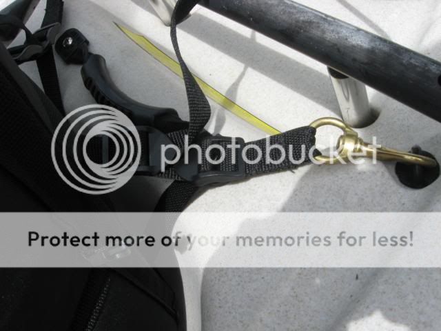

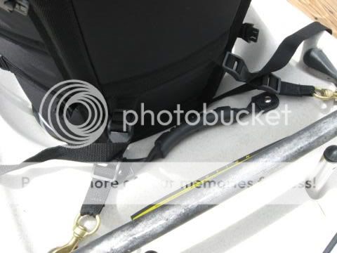

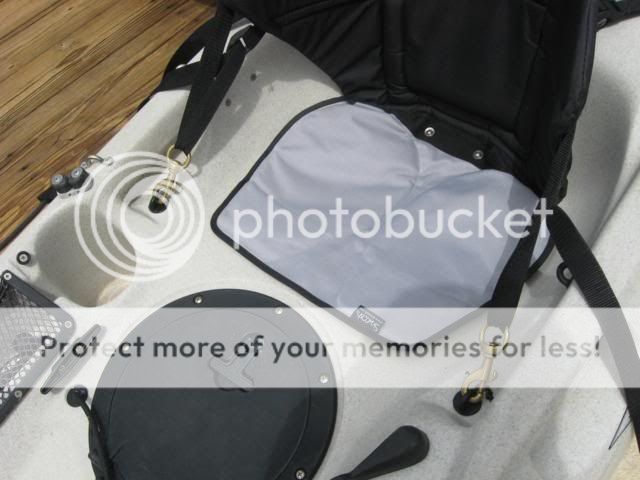

I pushed the pegs into the seat well holes then I removed the bungee hooks from the factory padeyes behind the seat and hooked the back straps on. Tightened the lower strap till snug and then tighten top portion.
I use the factory padeyes by the carry handles not the ones closer to the seat and that gives me better back support and less downslide of the backrest.
I will add two more padeyes to attach the bungee to since the factory ones are stronger for seat attachment.

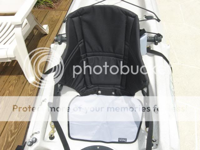

There is no seat slip and the backrest is very tight and supportive.
