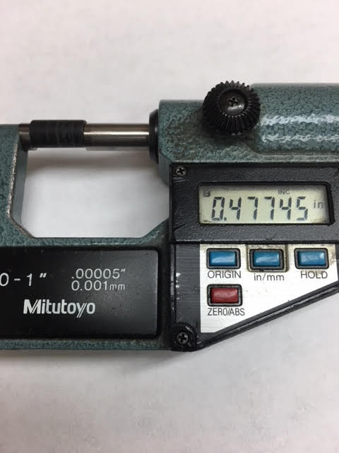

Measured a sample of four pieces with calibrated digital micrometer.
Diameter ranged from 0.2473" - 0.2497"
Length ranged from 0.4660" - 0.4775"
