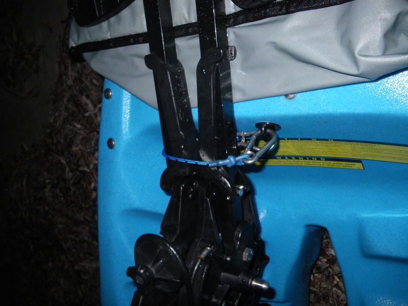

This is what I did. I never unhook it from shore to shore.

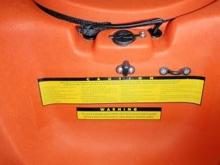

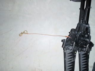

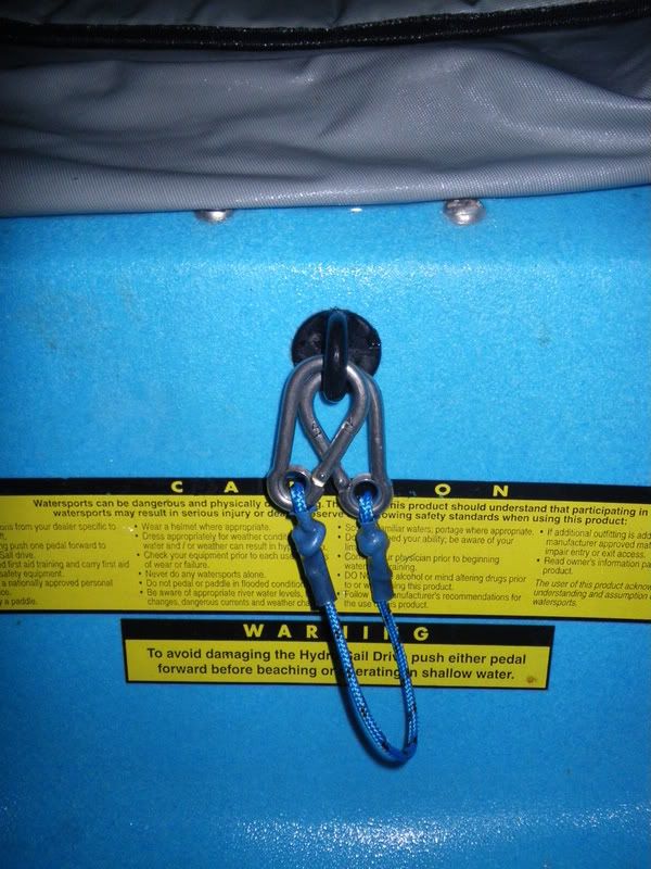

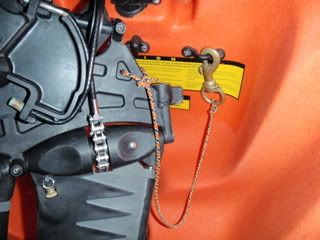

Sorry, but the problem is not how to attach the Mirage drive when not in use, but to keep it leashed to the boat at all times when on the water. Very easy to do with any number of different types of lines, leashes, wires, or cables. Some folks drill holes in the Mirage drive to which they attach the securing line. I prefer to use a non-invasive (no drilling) attachment setup using a SS shackle, as shown below. I generally use piece of parachute cord with a couple of fittings at each end. Here are a couple of pics of one of my current rigs.
