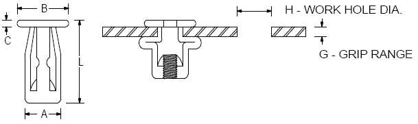

If you still just want a simple blind side application that would really work great you might try using these "Jack Nuts" as they should hold much better than well nuts.
The ultimate tensile strength of one #10 Jack Nut in 3/16" sheet is 640 lbs whereas a #10 well nut in 3/8"" thick sheet is still only 260lbs.
In other words the rubber well nut has less than half the holding strength of Jack Nuts even in material that is twice as thick !!
The #10 Jack nut can use the same 3/8 dia hole as the # 10 well nuts that come with the sidekick kit and yet the load is spread out on the back side of the hull base material much wider than with well nuts so pullout should not be an issue even if lifting with the sidekick cross bar.
JACK-NUTS ® are an economical Threaded Insert designed for use in thin, soft or brittle materials.
During installation the body collapses on the back side to form legs which grip the inside of the mounting surface.
Fastens in blind holes
Won't distort soft plastics
Not hole diameter sensitive
Can be installed in uneven materials
One-step installation with manual or pnuematic tools

The Jack Nut looks like a stronger alternative to the wellnut. I do not think they are available locally but can always order via the web.

Found this page on the POP Jack Nut:
http://www.thread-rite.com/pop_nuts/jac ... lation.htm
PostPosted: Sun Sep 28, 2008 12:00 pm
Posts: 395
Location: S.E. Florida
Jack Nut search results:
Jack Nuts are economical blind fasteners designed for use in thin, soft, or brittle materials. When tightened, the body collapses to form legs which grip the inside of the mounting surface, leaving a permanent, reusable threaded insert.
I found them in quantity only (100 per box) at around $30 USD. You also need buy either the install tool at $40 USD or the wrench which I have not found a price on. They are available in brass but also in quantity and special order (you have to call for price/quantity). This makes for a pricey alternative.
These are not intended to be removable. See previous post for web address with more info on Jack Nuts.
