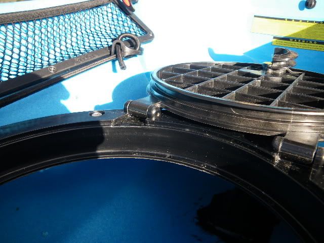

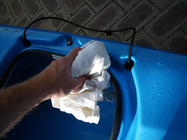

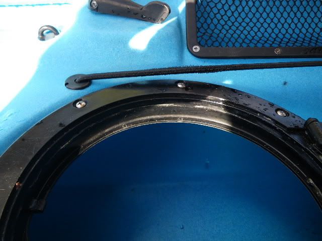

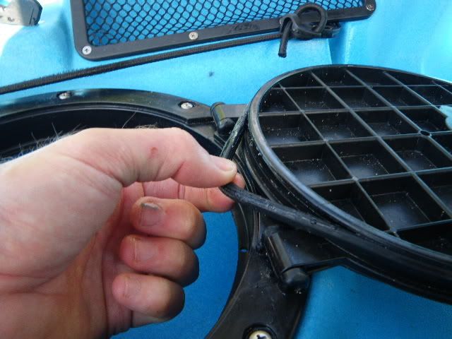

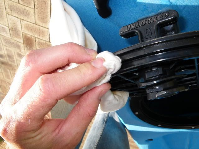

Now we are getting to the important stuff, hatches. I inspect and clean every hatch on my kayak.

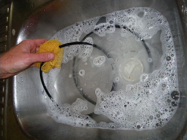

With the front hatch i check the seals are intact, and wash and wipe them clean. The circular hatches require a bit more attention. You can see the crap that builds up around the rubber seal, and the lip of the hatch. I remove the rubber ring seals, and wash the sealing surfaces, and the area behind the rubber ring.
I then take the rubber ring seals inside, and wash them in warm soapy water before refitting. A gentle inox of all the hinges, and handles on the hatches finishes the job.
No leaks for me, and smooth opening hatches all round.

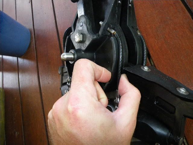

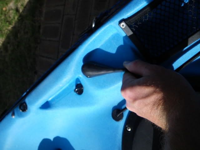

I now run around the deck and check all the deck fittings to ensure they are all operating correctly, paying most attention to the rudder assembly.

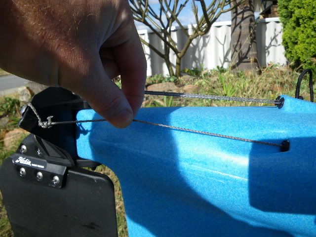

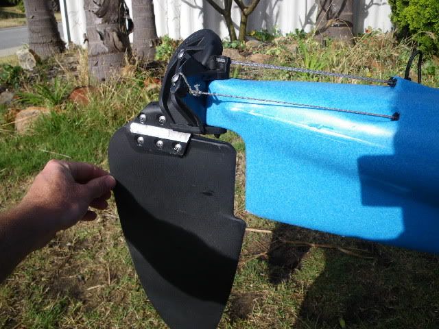

Check the tension of all the rudder lines, make sure the retaining knots are all tight, and the pin holding the rudder assembly on the yak is okay. Also grab the blade of the rudder and ensure there is no unnecessary movement, and its all solid.
Lastly check the rudder handle is tight, central with equal movement in both directions. And double check the grub screw on the rudder lever hasnt worked loose, and lubricate the whole assemble with a dash of INOX.

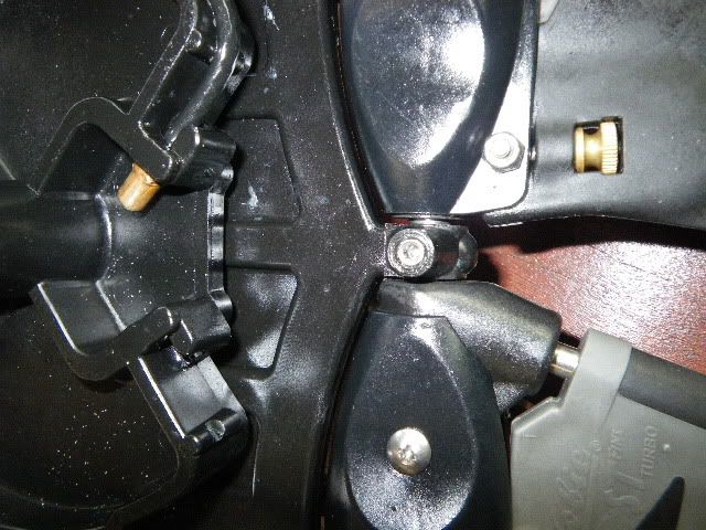

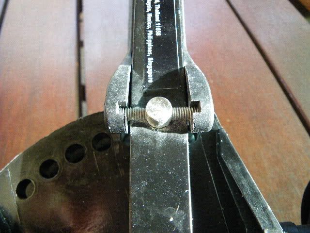

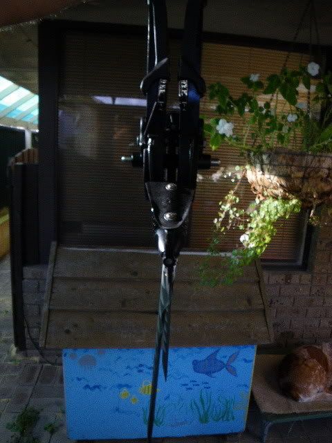

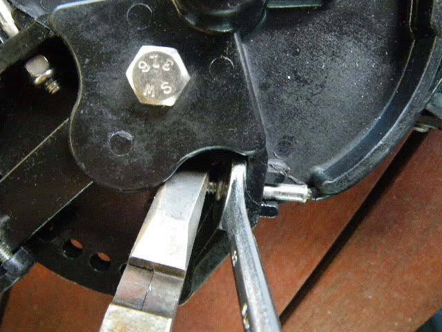

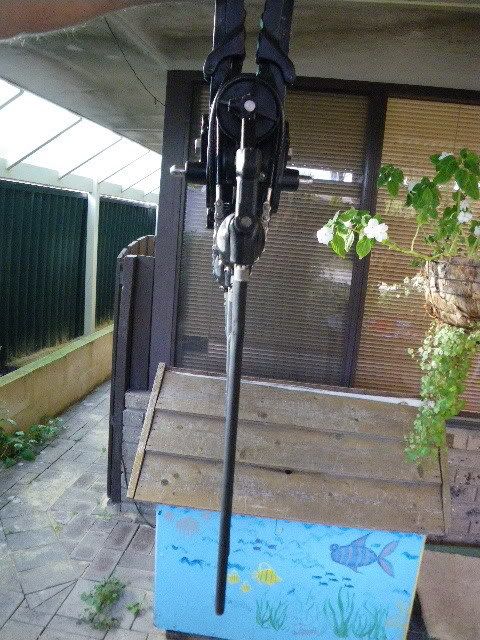

With a Hobie being predominantly pedal driven, the condition of the Mirage Drive is of the upmost importance. Firstly i run over the drive checking all the grub screws holding the assembly are tight, and locked in place.

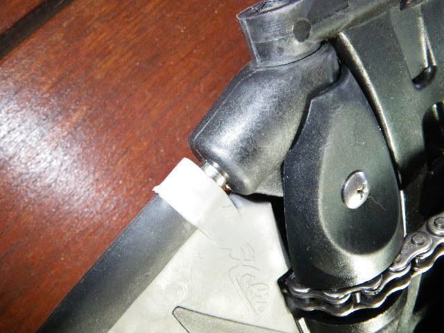

Also check the masts are securely fastened, and adjusted for tension. Check both fins are straight down when the pedals are together, in my case they weren't, so an adjustment of the chains was nessasary. Also a great time to check chain tension and adjust if needed.
Also a good time to run over the entire Drive, and remove any corrosion that may be coming up.
A quick spray of INOX, and a wipe will remove nearly all of this.

Shufoy, excellent post. That's a nice looking Adventure -- an '07?
I see that INOX makes several lubes. Which specific product do you use?
Your pictures show that you keep your fin clews tight. Have you tried loosening them to allow for more warp? 8)

Thanx for the reply Roadrunner.
By clews i assume you mean the brass screw thingy's! I have actually loosened them right off, i suspect when i first fitted the turbo fins i did them up WAY too tight, and may have stretched the outer edge of the fins. If you look at the pics you will notice a kind of wrinkling on the rear edge of the fin membrane. Or does this happen to all fins?
So yeah i have loosened them a lot from where they were, and noticed a definate increase in ease of pedalling.
She's actually an '08 Adventure mate, and wifey has an '08 Revo. She has certainly done very well by me since purchase, as i do 3 trips a week, every week. Only minor issue i had was the grub screw on the longitudal shaft the fins pivot on wasn't aligned on the flat surface on the shaft, resulting in the shaft working its way out a bit, an easy fix tho.
