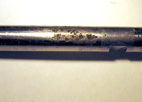

Perhaps this pitted Sprocket shaft is the culprit.
This is a close up of one area, there is pitting all along the shaft. The area with the most pitting created the most wear. To be clear, both plastic sprockets are worn but the worst sprocket wear happened on the side with the most pitting. Makes sense.
OK this shaft didn't seem to bother my SSteel sprocket & bushing setup - at least after almost a year of use. But, obviously V2 sprockets need to be (& should be) treated to a nice smooth surface. And, I'm trying, once and for all, to eliminate SS and use the V2s - got 2 more drives after this one to update, I hope.
If the pitted sprocket shaft had been a crankshaft I would have sent it to the machine shop for turning.
Is this a defective Sprocket shaft?
I didn't think this happened to Stainless Steel?
I have 3 Sprocket Shafts that are 6-7 years old and they are scored but none pitted at all.
In hindsight, I probable never should have accepted a pitted Sprocket Shaft as a new one from the dealer - but it was mail ordered. If I had gone to a local dealer that carried an inventory I would have made him pick another one out of the bin :wink:

PostPosted: Tue Nov 18, 2008 11:18 am
Posts: 441
Location: Florida
Matt & Roadrunner
I am pretty convinced now that there had been some bad batches of Sprocket shafts.
I have before me 5 Sprocket Shafts - 3 are from older 6-7 year old drives. These 3 are worn but show no pitting. In addition those original 3 are very shiny & silvery in color. And THEY ARE NOT MAGNETIC. A very powerful magnet does not stick to those original Sprocket Shafts.
Now I have 2 replacment Sprocket Shafts, both purchased from BackYard Boats almost a year ago. One of them is pictured as pitted in my last post. One of them is brand new - never used. These 2 are dull in color not shiny, in fact the surface on even the new one has very tiny pitting along the entire surface - as if it was never finished properly. And THEY ARE VERY MAGNETIC.
These are 2 definitely different batches of metal. I have no faith in the 2nd new Sprocket Shaft as a replacment for the pitted ones. Since it was bought at the same time and likely from the same batch.
Again, not trying to beat up on Hobie - but I will need to get some correctly made Sprocket Shafts, and hopefully be able to return these 2.

The shaft and sprockets have always been bushed with plastic. There is not a metal to metal connection here. Current Sprockets are plastic.
Certainly we are listening. We have asked for the pitted shaft for inspection and are replacing the parts.
Remember though... this is a 6 year old shaft. Not sure we are going to determine exactly where the vendor went wrong after 6-7+ years since we likely purchased the part here.

No worries Bbuchorn. What you say is true about my folly for using a pitted shaft, however electrolytic corrosion has never been an issue on any of my drives for the previous 6 years. In any case Matt & Hobie have me all taken care of - they always do. :)
Actually my 3 shiny, non-magnetic 6+ year original shafts were never an issue - they are scored/worn, but not pitted. I happily bought new parts to replace them. The 2 8mo. old replacement(& magnetic) shafts are what has come into question. They are obviously stainless steel - as they don't rust, but even the unused one, when looked at closely, has a very unfinished look & what is best described as "micro pitting".
