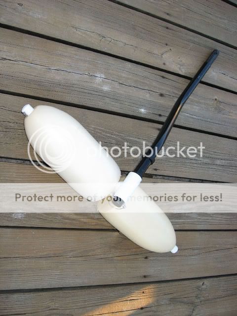

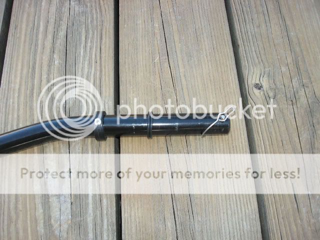

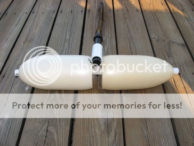

Much like Apalach's outrigger I made two foam outriggers with the 5" x 11" buoys that attach onto the Sidekick arms. Using a 1" Schedule 40 PVC 'T' perpendicular to the floats with a 1" to 1/2" slip reducer then the balance of the 1/2" Schedule 40 PVC t-frame, foam buoys & end caps as pictured in Apalach's post. I use 2 rubber 1/8" x 1" 'O' rings on the sidekick arm to keep them from sliding since the 1" PVC 'T' inside diameter is just a hair bigger than the sidekick arm diameter. Place the 'O' rings inboard just far enough to keep the "T" up against the spring clip.

Here are the puncture proof sidekicks I talked about. They fit on the Sidekick arms.
The 'O' rings keep them from sliding back & forth on the pipe.

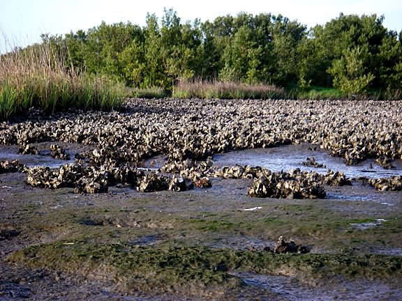

Lookin' good guys! All I know is that it might not take much to slice open a new Sidekick air escape valve on the oyster reefs/bars that we have up here in the Northern Gulf.
For example, here's what you do NOT want to run over, or thru, in your Hobie, especially with sidekicks.
Unfortunately, the skipper of this steel-hulled fishing boat misjudged the channel depth at Cedar Key and ran well up onto this oyster reef, much to his chagrin. Not only are the oyster shells extremely solid, but they are also extremely sharp and can slice thru most any average footwear in a heartbeat should you be forced to get out and wade.

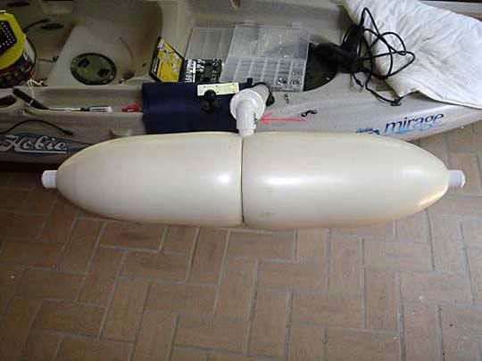

Whoa--someone hasn't been paying attention. The puncture proof amas (i.e. the lobster pot buoys) were designed to be as aerodynamic as possible (with a little jackknife modification), so that the flat ends snugged up against each other. There were no big gaps of any kind when I made mine, as you can see here.
Then, during my on the water tests, you can see the outriggers in action creating a nice ole WW II tin can "bone in the teeth" when underway at flank speed (or as close to it as I could get!).
The point being that the lobster pot buoys, (if designed properly) are just about as aerodynamic, and really no more subject to drag than the store-bought inflatable jobs, IMHO.

Hi Kepnutz & Apalach,
I STAND CORRECTED. The gap I left between the bouys is not aerodynamic and would cause drag. Thank You Apalach for the clarification. I did not experiment with cutting the lobster buoys around the PVC (wasn't sure if it would diminish the integrity and did not want to waste one) but yes they can be trimmed to fit them together tightly. The end caps really hold them tight.

Added note:
The PVC 'T' is not the same width as the sidekick end bar space between the clip and the fixed stop thus I use 'O' rings to keep the "T" tight against the clip which is fine for stability but under the pressure of hiked out sailing it would slide back and forth on the pipe. The 'O' rings would not prevent that and they would just get pushed up against the fixed stop.
Solution: Add a 1" PVC slip coupler between the 'T' and the fixed stop. You will need to cut down the length aproximately 3/16" and this will act as a spacer filling the gap and keeping the float from wobbling. Do Not
glue the coupler to the 'T' by means of a piece of 1" PVC because the inside diameter of the 1" Schedule 40 pipe is too small to go over the sidekick arm and you may find yourself having to start over again. TRIAL and ERROR!
OR: remove the rivet in the fixed stop on the sidekick bar and relocate it and re-rivet.
The fit is not perfect but it works for stability .. I will have to test it for sailability.
