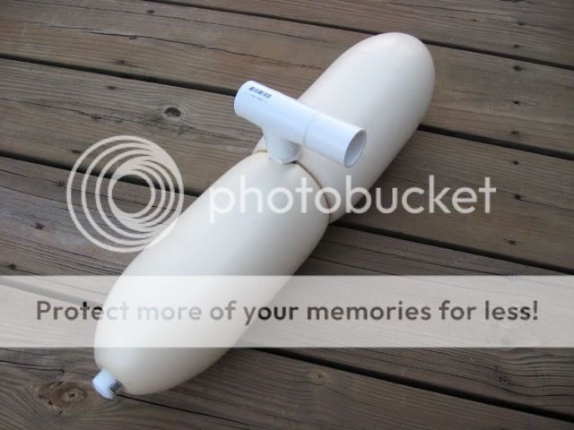

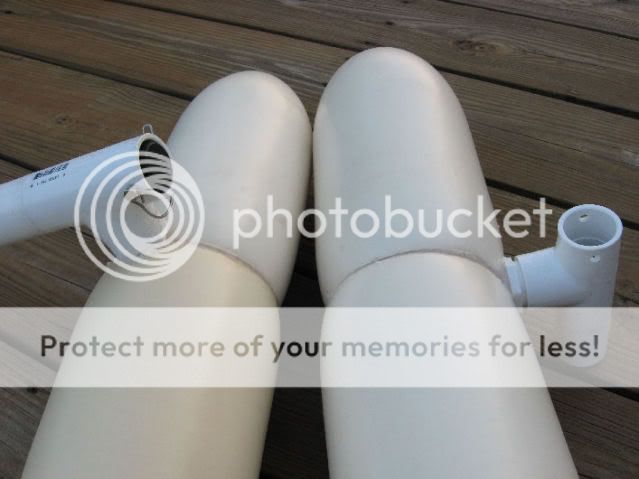

I reworked the lobster buoy sidekick and notched for the PVC bringing the two buoys tight together.
1. Silicone II adhesive can be used between the two buoys to seal the seam between the buoys for sailing and reduce drag or keep water from forcing itself between the buoys.
2. I added a 1" slip coupler to the "T" by glueing it end to end to the "T" with PVC cement. No 1" PVC connecting them for the 1" PVC inside diameter is too small for the sidekick arm.
3. One 1/8" thick "O" ring pushed against the arm stop as a spacer and the modified "T" fits nice and snug between the stop & the clip but with free rotary motion.
4. Before glueing the 1/2" vertical into the 1" to 1/2" slip reducer I placed a rubber stopper into the 1/2" PVC and glued in place. This stopper prevents water from entering the "T" and filling the PVC assembly with water.
Here is the modified unit:
I can now swap from inflatable sidekick to puncture proof sidekick depending on conditions and tasks.

Hey Revo,
Lookin' good--a very nice job!

Revo,
Looks very professional -great job! 8)
I'm interested to learn how they compare when sailing as opposed to the sidekicks. Buoyancy, resistance through water etc. I like the way you have adapted them to fit the standard sidekick bars.

how's it goin Apalach & stringy,
I hope to sail test them this weekend. The wind has been in excess of 20 knots & higher gusts this past week so could not give them a test. Well I could have but elected not to :lol:
I primarily built them for fishing just afraid I would be standing and that one sloppy cast and a hook would catch my nice inflatable then pop and over I go or tide skimming over an oyster bed and slice, pop and a kayak flat. For sailing I still intend to use the inflatables. I wanted an easy alternate option without having to build a completely different floatie rig.
I will sail test them perhaps today, suppose to have nice breezy conditions. Kepnutz was very interested in them for sailing since he has had a kayak flat for some time.

stringy as far as bouyancy each bouy has 15# bouyancy so 30# each side. I have stood and rocked side to side with the yak at 45 degrees & higher and the float totally submerged and no turtle. I almost went over but the revolution was stable and I was standing on the gunnel.
I will post result and maybe some vid or pics.
Revo

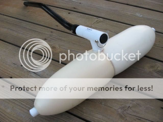

Sail Test update:
Sadly the sail test did not pan out as planned. The shape of the lobster buoy acted like a torpedo and not like an outrigger when leaning to the side as hiked out when sailing. The floatie dove nose first and pinwheeled under even just the sprint power of the pedals.
For added stability while standing they work fine but lack a proper hull shape to glide over the water without becoming a torpedo while hiked over under faster speeds.
For sailing the inflatable sidekicks works best.
Kepnutz, I would recommend you get that replacement sidekick.

The key difference between your setup and utilizing the sidekick arms is that the bouy is not FIXED as it is in your rig. The bouy rotates just like the inflatable ama thus makes it nose dive for a torpedo effect. If the bouy were in a fixed position and nose elevated the condition probably would not happen. Alas another test is due after devising a way to FIX the bouy on a sidekick arm. The rotation is needed in order to utilize the 3 position settings or as you rotate the bar you rotate the floatie if fixed.
The 3 position option may have to go by the wayside.
I have never said lob bouys don't work ,, thus far they just are not working on a sidekick bar. I could see while I was moving along if they were fixed and nosed up they would possibly work ok. How they would react even fixed to a substantial wave I cannot answer without field testing.
Perhaps a slip pin through the PVC "T" sleeve and arm keeping the floatie in fixed position will work. Fixing the floatie will of course negate the position adjustment except maybe from lowest to highest will invert the floatie to clear the water when not needed.

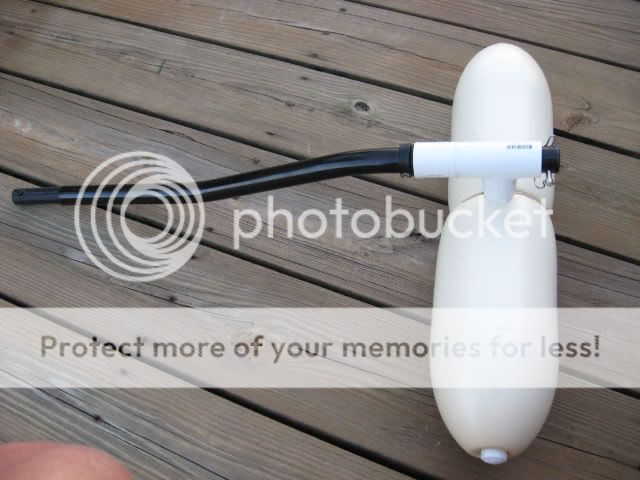

I Fixed the lob bouy floatie onto the sidekick bar via a hole drilled 90 degrees to vertical in the PVC "T". Using the sidekick retainer clip you can clip the floatie to the sidekick arm. By tilting the sidekick center bar bottom hole slightly forward about 5 degrees from vertical that will set the floatie at a 5 degree nose up attitude. This should be enough nose up angle as well as the fixed position will stop the torpedoing. This does negate the 3 position option giving you only an up or down position where in the up position the floatie is inverted. One could utilize multiple hole pitch angles to make use of the 3 positions but it would be advisable not to swap pin positions over open water hence the retainer clip could be dropped and go to the bottom never to be seen again.
For non sailing uses like flat water & level pedaling and standing you can keep them free to rotate and they work fine. For pedaling in chop with floaties the fixed position would be warranted.
Pics of the fixed Floatie:
