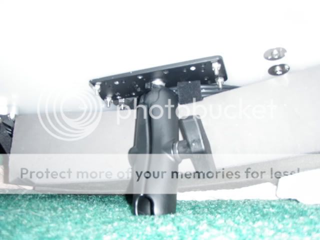

Near the stern, I used sS screws to screw padeyes onto the Scotty holders themselves. Those were left over
from last kayak, for my flyrod. Rarely used.
Later, I'll post night photos with the flags and Stern light and fishing rods etc.
I used RAM balls, ALL 1-1/2" for this kayak's "Modular" system. And 1-1/4" crosses, pipes, 45 degree elbows, plugs (for flagpole) and reducers (for light pole) for this kayak's "Modular" system.
The 1-1/2" "wedge mount" ram ball in the sail mast tube holds my FishFinder/GPS/dual Rodholder/Pliars table.
I made the "table" with two stacked 16"x20" cutting boards from WalMart (under $10.00 each) and the Ram 1-1/2"
Electronics mount, compass, a small drybox with two 8 AA cell battery holders, the folding transducer arm from
"The Liberator" a couple wire rodholders from Walmart, and my waterproof Nuvi 500 GPS in boat mode (with
waypoints of brushpiles, markers/marinas/ramps etc, and underwater contour maps loaded from a sd card)
I MIGHT cut the "table narrower, cut a carrying handle hole in it, drill holes to hang lures on in front, etc
.... still playing with it now. That's why I got the large 16"x20" cutting boards, the Liberator was too
small, and this can be shaped or cut to whatever I want. I made a hole in front for needlenosed pliars, but
hesitating to cut just yet, till I figure what I really want to do with it.

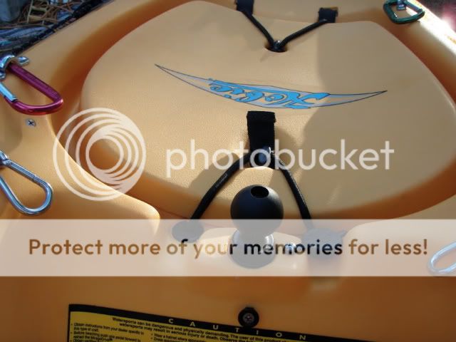

I put an extra ball (came with the electronics mount used as table, which I mounted on the wedge mount, so it was "extra") amidship in case I want to move a rodholder back towards me, or use one rodholder tube as an outrigger/Sponson/stabilizer (I made these, never use them much.) Or, to move my Fishfinder/GPS/dual rodholder table there some day?

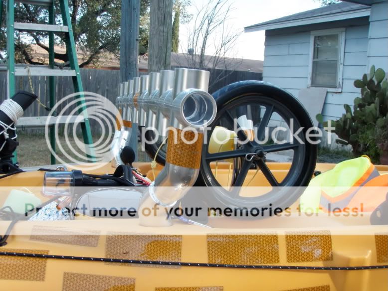

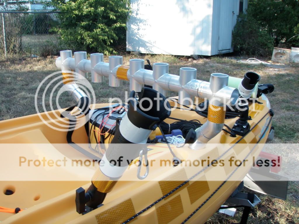

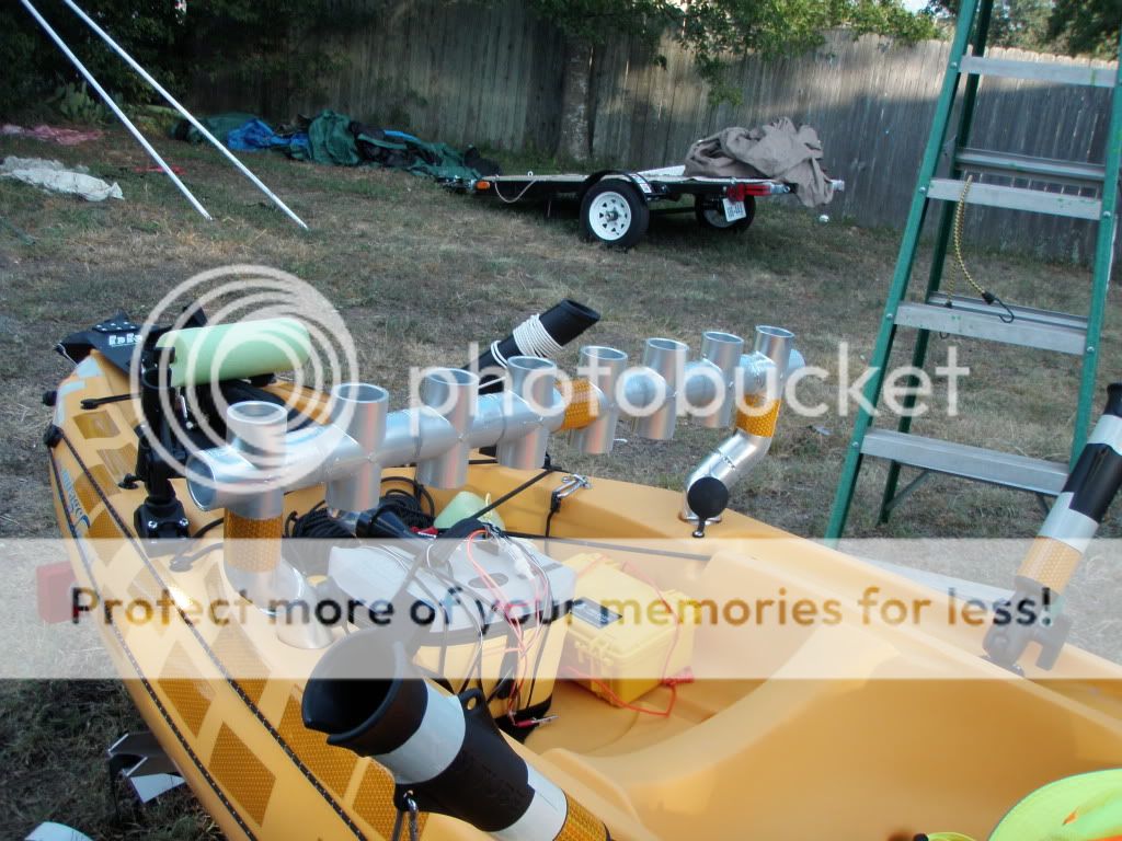

Behind-The-Seat "Modular" cross system (for Net, flagpole, umbrella, "stern light", stakeout pole, etc)
I wanted my crosses to butt right up against each other, so the glue not only glues the outside of the pipe to
the cross, but glues the end edge of the pipe to the inside ridge in the cross, and glues the end edges of the
crosses together at the edges too. To make a "jig" to cut the PVC the correct length, I inserted a small piece
of cardboard in as far as the ridge that meets up with the pipe. I marked it, folded it, cut the cardboard to
length. Then cut it just a hair shorter, mark the pipe and cut pipes to length.
First, cut your "cross-joining" pipes to length and de-burr them (scrape burrs off with a knife inside and
outside the pipes)
Next, glue on a cross to the first pipe.
Next glue on a second cross to the same pipe and press the two crosses together completely, lay it doewn on the
concrete sidewalk/driveway and make sure both crosses are in a straight line. Glue in one end of the next
pipe, push it all the way in, glue on one more cross, lay flat on the concrete, straighten them so all in a row
.... repeat till done with 5 or 6 crosses (later insert two 1-1/4" PVC pipes into the two recessed rodholders
on your kayak and hold the cross assembly behind the two pipes to see what width you might want, if you want to
add more crosses, my first one used 6, my current one uses 8 ). for net, stern light, flagpole, stakeout pole, rods, umbrella, etc
Mark, Measure and cut the two PVC pipes standing up from your built-in rodholders. You want then just barely
sticking up from the kayak enough to fully fit into a 45 degree ell all the way ( the mark where it comes out
of the kayak, plus about half the cardboard "jig")
PostPosted: Tue Jul 07, 2009 9:14 pm
Joined: Fri Aug 22, 2008 5:28 pm
Posts: 139
Recessed rod holders go in at 2 angles, they angle towards the stern, and they angle toards the water.
I used two 45 degree ells/Elbows on each side to take care of variables like having it level and plumb, moving
it towards the seat or towards the stern, and adjusting for width, whether you use 6, 7, or 8, crosses. (Last
kayak had 6)
You can leash the cross system anywhere, and leash things to it. I spray painted mine chrome, and added loops
of school bus reflective tape, just because.

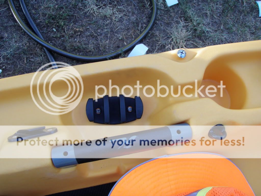

When installing Padeyes, I used the largest SS washers which fit inside the curvature/space, and then ALSO put another padeye inside the kayak on the 2 bolts, on top of the washer, then the nut, in case I want to leash something inside the kayak so it doesn't slide out of reach, or to retrieve it easily by pulling the leashed thing to me while on the water. (battery/gear bucket/drift chute/drybox with wallet-keys-fishing license/soft bag cooler or whatever from inside the kayak)

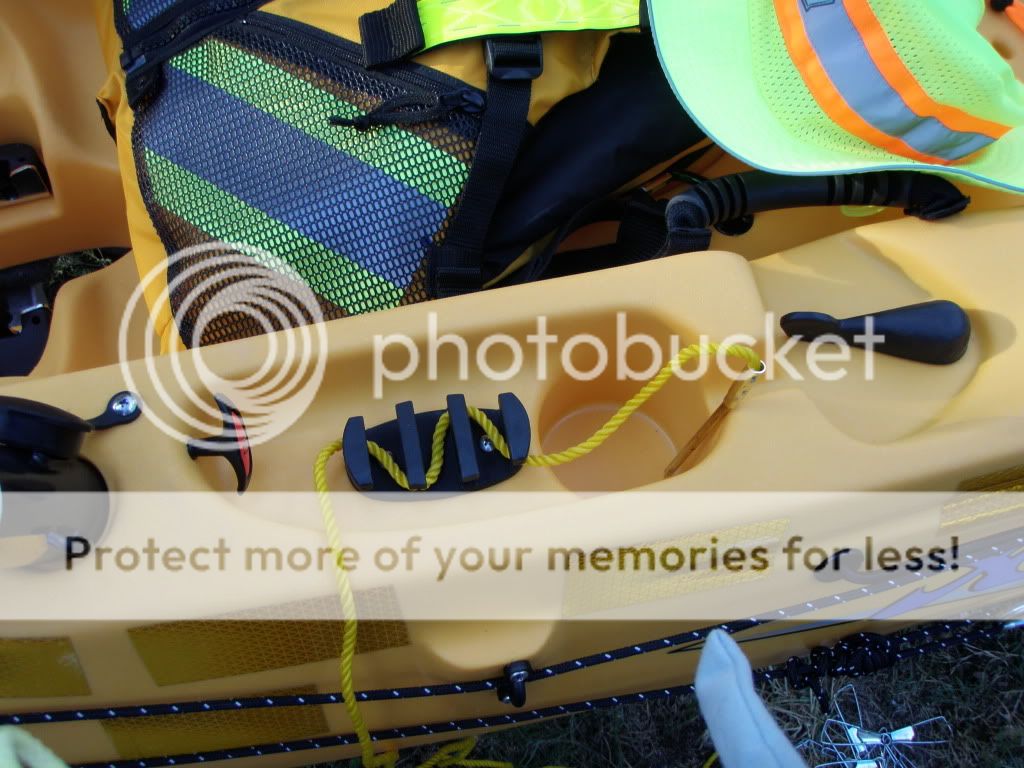

Also, I have zigzag anchor cleats on both sides of my kayak for anchor or fish stringer/basket, or to rig my
leash into a "rope ladder" step to assist my re-entry if I'm exhausted tired. Leash is about 12-15 feet long;
long enough to make a loop on one side, and use a spare rope for the other side, going under kayak (Can use a spare rope as tied off on opposite site cleat and going under the kayak, as sort of a "paddle float"-tie off the opposite side system)
