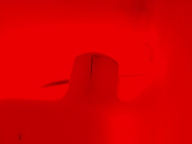

I have not seen this issue before, so I'm putting it out there for others to watch for. My 09 Revo developed a small crack/split on the port side, forward drive well area inside, at the location of the moulded in relief point thats sticks down for the Click and Go screw/nut placement. I have lost all confidence in now taking her offshore as it looks to be getting a lil bigger as of the last use. I have only used this particular hull 3 times. Noticed it after second trip and thought it was just discoloration but last night it looked wider pronounced and I actually was able to put my fingernail in it. I will post a pic ASAP. Can't believe it, it's otherwise a pristine hull with out a scratch.
After further inspection tonight I noticed it had spread to a T type of spider leg split vice a single line split. To even attempt to fix you would need to dis-assemble the port click and go, drill the ends of all cracks/splits and center of the spider then apply adhesive to secure as a temp fix. Given that this is the actual anchor /stress point for the drive it will eventually spread and the Click and Go WILL fail as its grip releases and comes out of its anchor housing. If the fitting is a press/adhesive fit or a spread fit by way of tightening the allen head screw it may have been over tightened at the factory or insuffient material adhered to the fixture relief setting during manufacturing.

Sammy, sorry to hear about the problem. Since this seems to be quite rare, yet was only the third time out for this boat, it seems likely this was a rotomolding defect.
I think a quick and easy fix (at least for the time being) is to find a PVC cap that slips over the split piece, fill it with Scotchweld DP 8010 and cover the entire protrusion. That should take care of it permanently. Yakaholic has applied this product and technique successfully to split seat plugs. I've also used the 8010 in high stress areas with excellent results.
I don't think you need to bother with drilling the splits, etc, since the glue should be capable of handling all the stresses while containing any damage. Use the usual safety precautions -- double latex gloves (or equivalent) and good ventilation.

RR, thanx for the reply. Initially that was the idea, to cover it in a cup and fill the cup with the adhesive. After feeling around front and back, it is an elongated setting/molding. Even if I could, I don't find it a permanent solution as I don't want to be at the 1yr 11mo point and have a further deterioration stacked against the warranty. Also during the inspection last night I noticed the same initial discloration on the starbord forward setting, you can see a part of the Click and Go mount edge thru the plastic. It is a black vertical line about 1/16th to 1/8 wide exactly where you see the split in my photo. The aft areas on both P and S do not show this. I 'm wondering if that is next!! :shock:
also of note,,, to me personally is my confidence in this hull is no longer 100%. I MUST have that to continue going offshore in this craft. Thats why I paid top dollar, its simply the best craft made, 3 modes of propulsion. I need that to ensure I'm getting home. I don't want to sweat/freak 5mi out. Too many other things can go wrong at sea. I can't even explain it to the wife.....I've got well over $5grand in gear and add ons tied up in this.
I defer to what Matt has stated to others in the past about trying to apply a fix in the well area----

I'm good, just contacted the dealer and he said "no problem with the warranty. Replacement hull ordered." WOW, thats what I call great!!! :wink: :D
