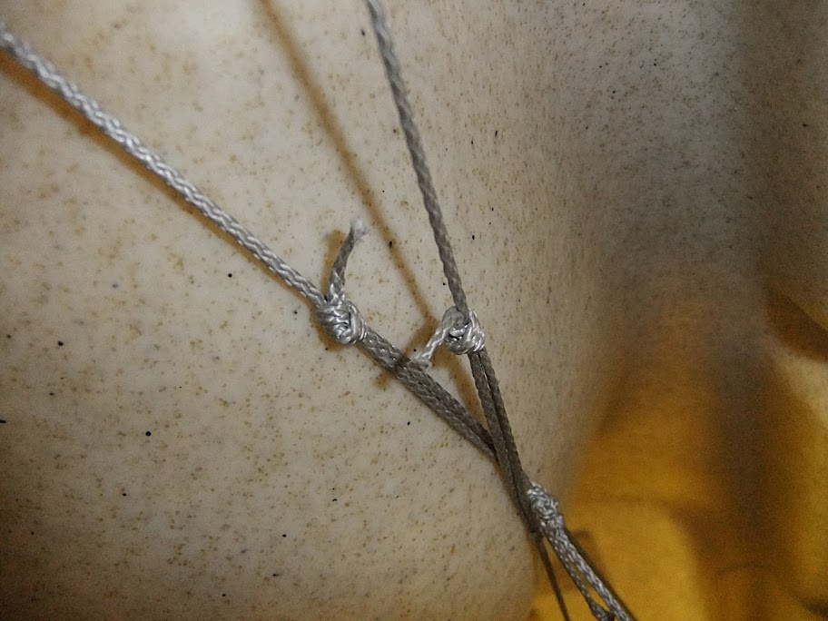

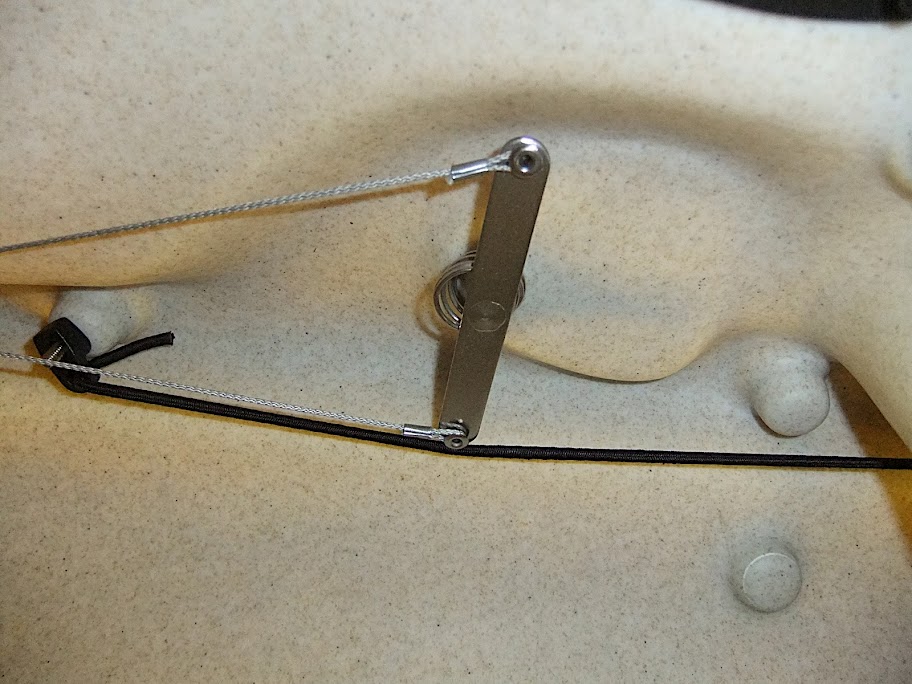

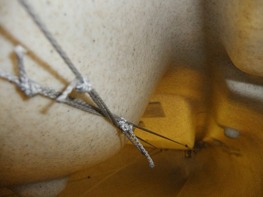

When moving the tiller from port to starboard I feel a big resistance when in the middle position.
When applying more force, I feel and hear the lines stretch, at a certain force the lines jump loose and the rudder deflects to starboard in a fraction of a second.
This is what I found inside the kayak:
The tiller is rubbing the bungee of the rudder-up line
The two rudderlines rub against the sittingmould
The rudderlines rub against each other AND the knots in the lines hook into each other !!!
This is how it looks if I pull the lines apart, this helps for while but with time the problem returns.
The lines creap back together.
I tried teflonspray to reduce the force with which the knots hook into each other, but :(
For bigger pictures have a look at http://picasaweb.google.com/11028066354 ... sTechniek#

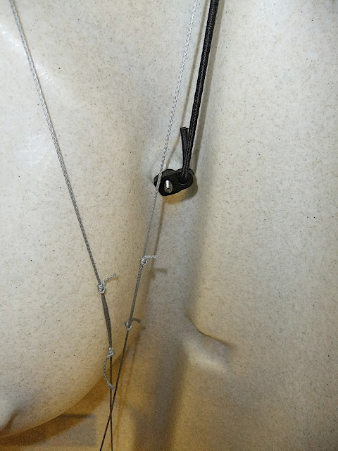

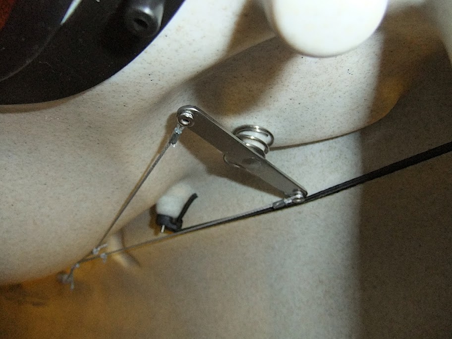

Here's what I see inside my new Oasis...
I should mention that in all of the pictures below, the Kayak is hanging on its left-hand side. Things may look different when it is in the normal use position.
BELOW: I don't see any binding here, but the cord rubbing along the bolt threads may become a problem over time. I suppose if I deflected the rudder to extreme left, the bungie could hop over the button and become lodged as yours has.
BELOW: My knot clusters seem to have enough separation, though I didn't try deflecting the rudder to see if they passed each other.
BELOW: It appears that, for some reason, my rudder cables cross each other at a position farther behind the knot cluster than yours.

Hello Skadar,
It looks a bit different in your Oasis.
It looks possible that the bungee could get caught on the button, have you tried to swing the tiller full left?
It's because the bungee is under the tiller that the spectra line is pushed upwards and is touching the thread.
In mine the spectraline is not touching the bolt.

To clear the bungie, you can move the bungie to the other side of the crank and rotate the black bungie terminal about 90 degrees and it will pass clear of the end of the crank. The steering lines are twisted which is causing the knots to interfere with each other. If you disconnect the line that is trapping the other line and place the steering line on the other side of the opposite steering line that should free up the lines so they don't interfere with each other.
