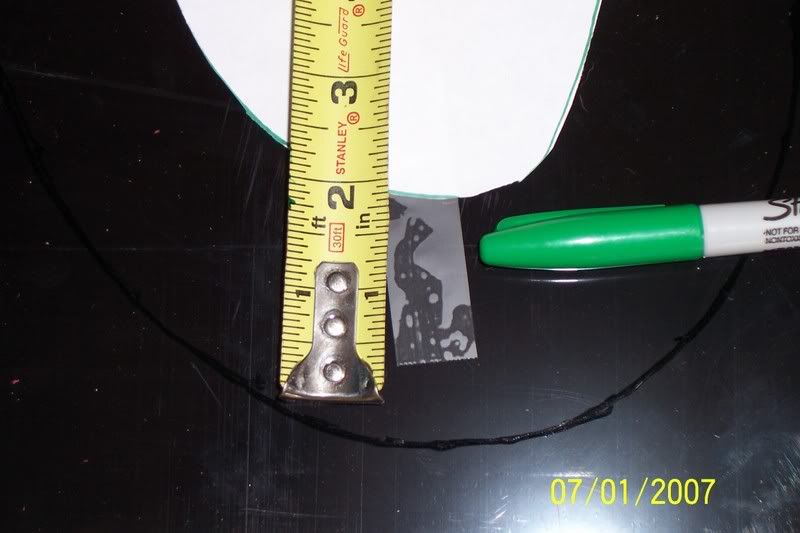

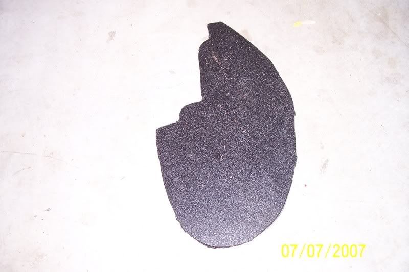

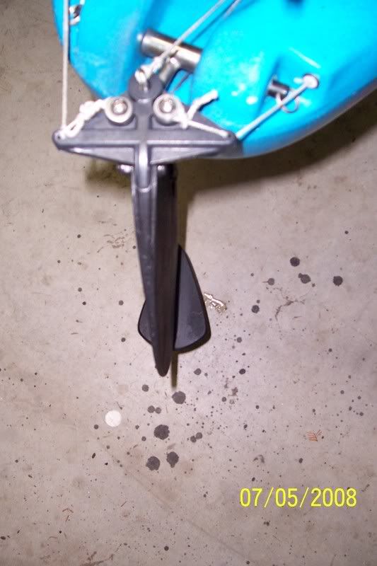

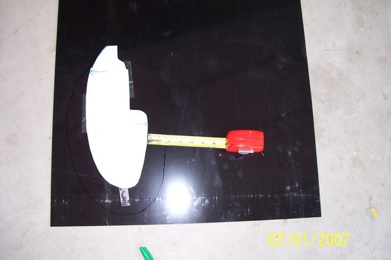

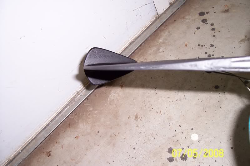

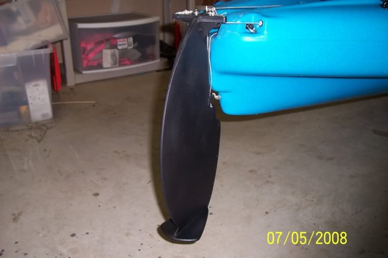

One thing I did with my old style rudder (2006) was to increase its size and effectiveness by bonding a clam shell cutout of plastic material I made to make the rudder even larger as well as adding a small winglet to improve its bite and to aid steering when encountering boat wakes , waves and rough water or when sailing. The improvements made were well worth the 15 dollars of material and extra time and were not that difficult to do plus its still working well three years later. Just my 2 cents if that helps any.
