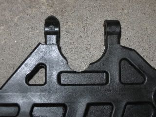

I wound up replacing the spine as there was a crack in the middle support under the set screw. I did notice the replacement spine has a semi-circular cutout in the composite where the idler pulley is located.
On the pre-'09 drives the composite is solid there, but a groove has been worn into the material. Obviously Hobie has redesigned the spines to take into account the wear in this area. I've since filed out some of the composite on the older spines to match the shape of the newer spines, to eliminate any friction or problems in this area.
What is the cause of this wear in this area?
Bob

Excellent observation. Hobie used a different style idler pulley years ago. It appears when they changed to the current pulleys they allowed only minimal clearance (left, below). Overtightening the idler cable could wear the idler shaft and eventually bring the pulley in contact with the spine. Hobie evidently corrected this as you noticed when they also incorporated the hole for the tether mount. 8)

As always, thanks for the feedback and solving the mystery!
