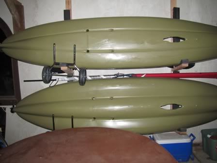

I built this rack thinking that it would be the best use of limited space and keep our new babies happy. Now, after reading some posts I am having second thoughts. I am posting some pictures because as they say a picture is worth a thousand words... Can anyone comment on the long term storage feasibility?? It's made of 2x4's and has a 15% angle.
Thanks in advance and hope to hear back.

Why are you having second thoughts?

On the side rails... resting on wide, flat 2x4s and padded too? No problem... Perfect in my mind.

The 2010 Outback I bought yesterday had been left on the Hobie cart and had a slight flat spot where it was resting on the cross bar. It is something to watch for.

Thanks guys, I was a little concerned about flat spots and warping. Thanks for the feed back and easing my mind.

I have my Outback mounted on side racks and I have found that it does put indentations in the side in hot weather. Consequently I am looking at a redesign where the kayak is stored upside down on a rack. Particularly now we have bought a Sport for my wife and will have to extend the rack. Fortunarely the plastic has good memory and the indentations came out of their own accord.
