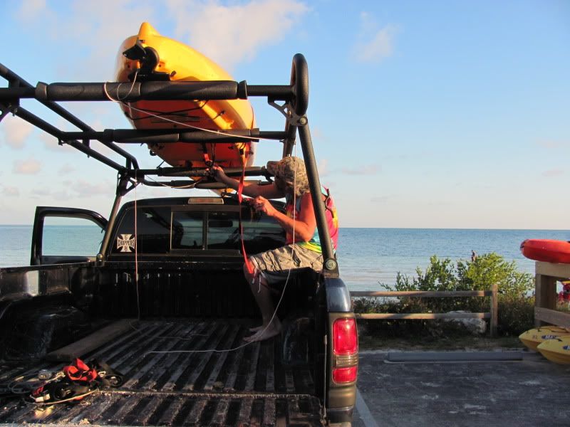

Photoquests had a similar problem. Here's a link to his solution -- unfortunately the pics are missing. Maybe you can PM him for some new ones. He did a beautiful job solving both the space problem and loading the boats from the side. 8)
viewtopic.php?f=73&t=27966&hilit=kayak
