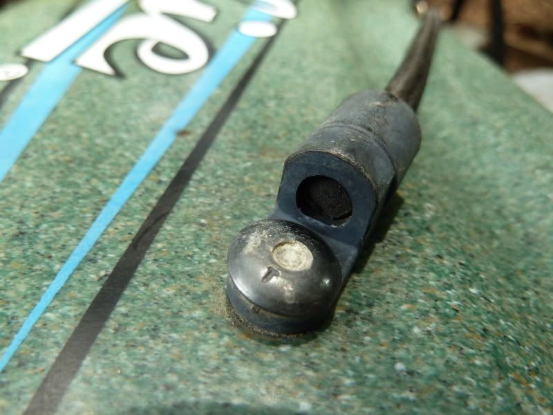

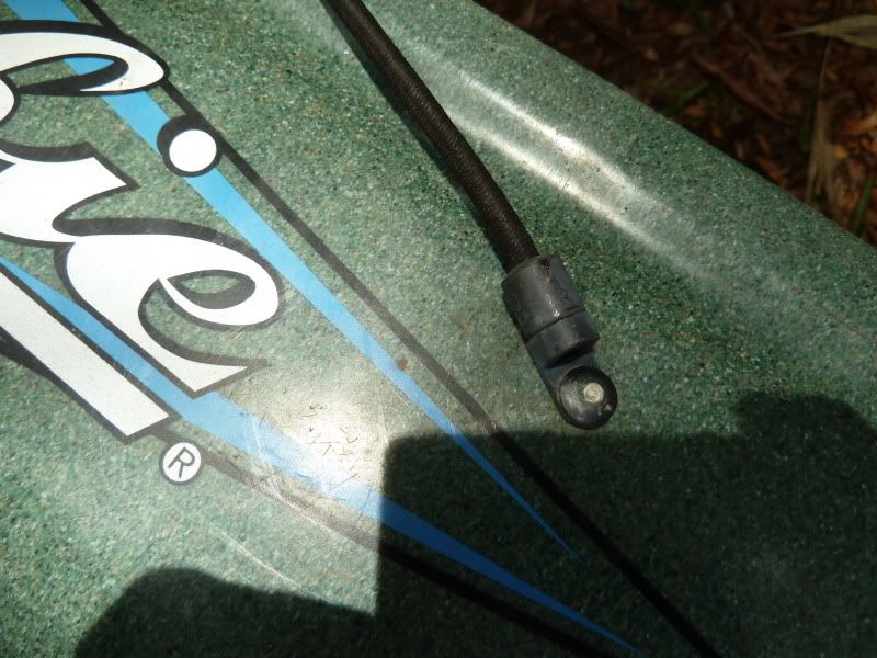

4- The paddle rest bungee is a bit stretched out on mine. is there a way to tighten this up? The "clips" that the bungee is attached with don't seem to allow adjustment and they're riveted into the kayak with SS. Maybe I'm missing something about those clips....

You might need to post a picture of the riveted holders. I am not aware of these. The hobie catalog list a tool that will remove the screws out of the yak. Then you can replace the elastic cord and then screw back in. (Do you have access to a Hobie dealer to discuss all these repairs?) they are well versed in helping the Hobie owners.

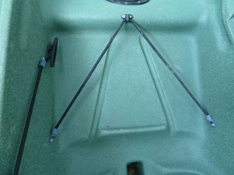

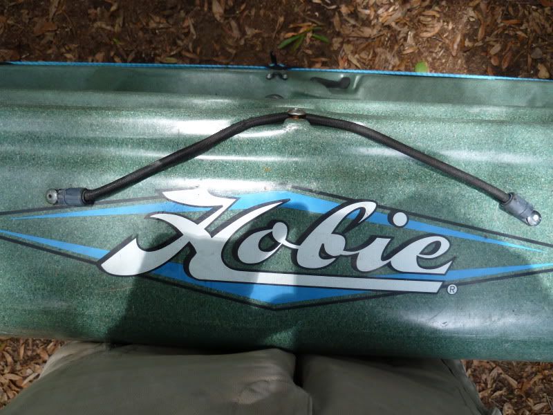

I did visit the local Hobie dealer about 30 mins away. I didn't take the boat, they didnt' have any Outbacks there and no one there seemed familiar with the 03 model so I came here to ask.
Here are 3 images:

I had not seen the rivet before. The black plastic clip has two pieces and the piece not touching the rivet will slid up the cord. Then you will see how the cord is fasten to the second part. I would not attempt to seperate the two pieces unless you are willing the replace the whole system. Looks like the plastic is now brittle and might break with the prying apart.

With these early hulls many of the current molding techniques were not yet utilized (like embedded threads). Additionally, the concept of hull access was not well developed. Consequently, the only way to attach parts to inaccessible areas was by rivet. These have not been used for several years.
If Hobie still has any of these old parts available, you could drill out the rivet and replace it in kind (inquire through the nearest dealer, as these are not in the current catalog). If you can mount a small hatch (need a flat spot) within an arm's reach, you can use through-hull fittings instead. Otherwise you'll have to live with it or adopt an alternate solution. 8)

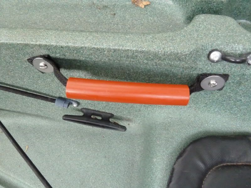

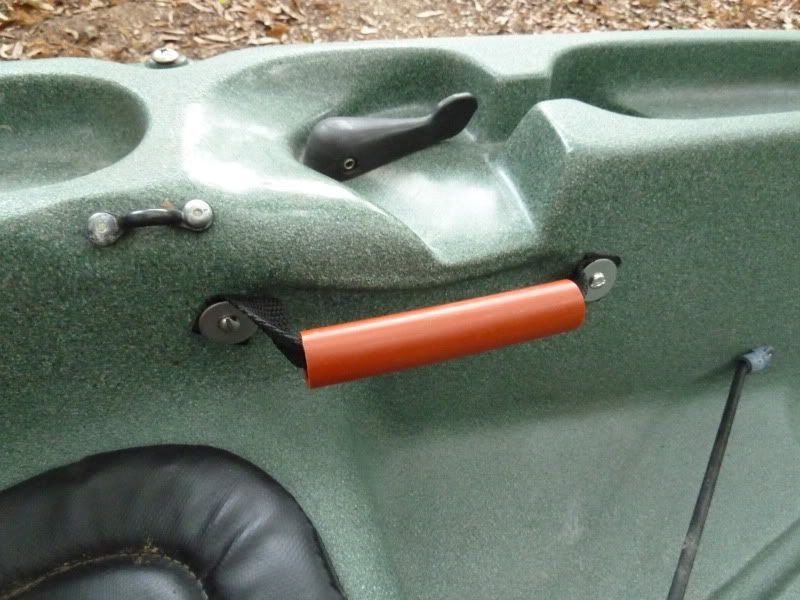

This was my solution to the missing handles on my outback:
Image[IMG]
Just simple nylon strap and stainless hardware with a piece of pex pipe for the handle.

That should work great. Did you use a metal plate inside the yak for the bolts? Good Luck

I used large fender washers. Larger than the ones on the outside shown in the pic. In case anyone else is following this, I also fitted a piece of plastic over the one bolt end that could potentially come into contact with the rudder control line.
I might tinker with the handles some. As it is, when I grab it and swing it over my head, my fingers can trap between the handle and the boat (ouch) if I don't have it gripped right. rigid handles might work better.
