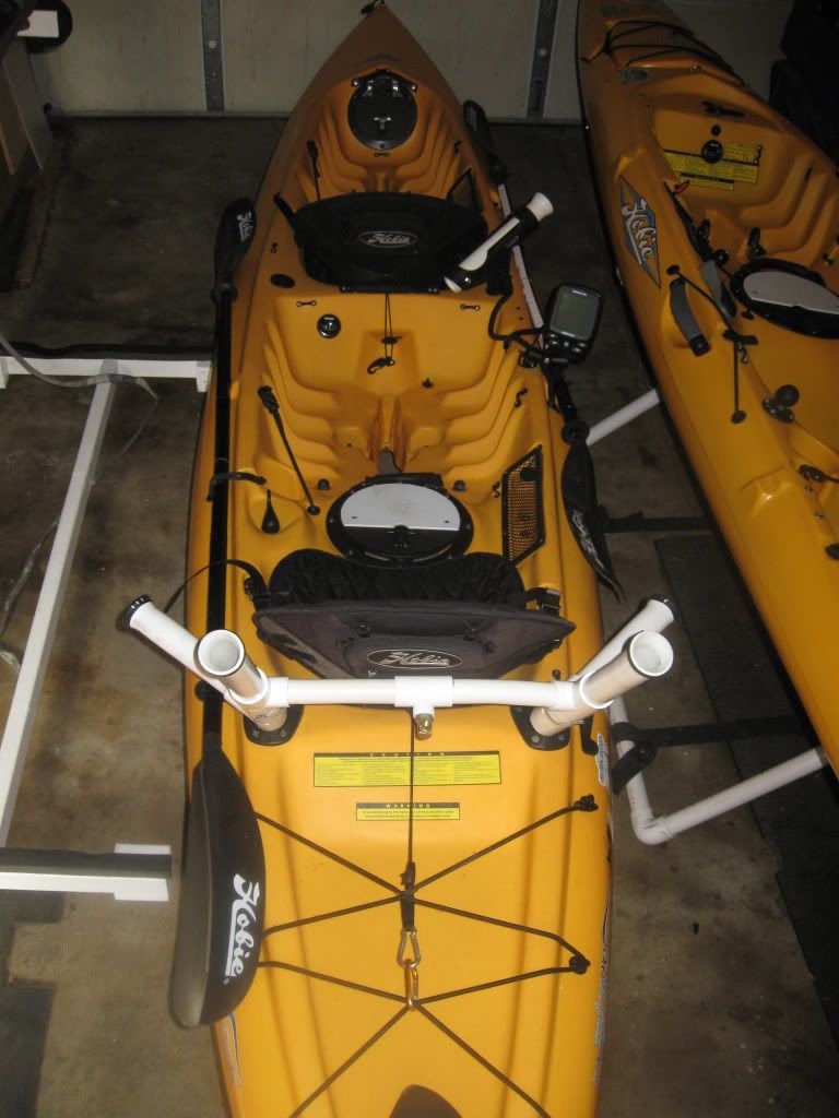

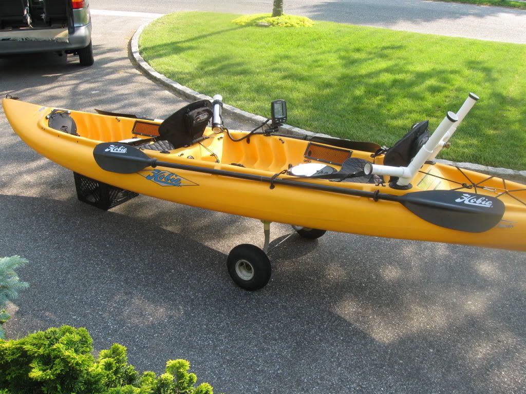

I set up my '08 Oasis for fishing w/ Scotty compact threaded mounts behind front seat and recessed rod holders behind rear seat and built a pvc trolling rod holder and rod carrier w/flag mount to fit in them. (attached pics)
If I was to do it all over, I'd still install the Scotty compact threaded mounts and rocket launcher rod holders behind front seat and would install Ram tube rod holders behind rear seat.
I've done it this way on my '11 Oasis and it works great! Also with the standard flush mounts on the new Oasis, I built a pvc rod holder to slip in giving plenty of vertical storage for rods, net, light.

Bob,
Nice setup. Can you provide more detail on how you mounted the cutting board on the hatch? Thanks

It's just bolted through hatch lid. On the '11 Oasis I just used marine goop to secure it, just as secure, and no residue gets stuck in screw recess!

How did you flare the PVC ends?

I heat up the pvc with a heat gun until it is soft, then push an empty wine bottle into softened pvc until I get the desired flare. Wipe the pvc with cool wet rag, while still pushing in bottle to maintain shape, till pvc cools and hardens. Takes a little practice, but easy to correct mistakes, just reheat and try again!
If you want to form smooth bends in pvc, fill with sand first and cap ends before heating and bending, it will give a more uniform bend.

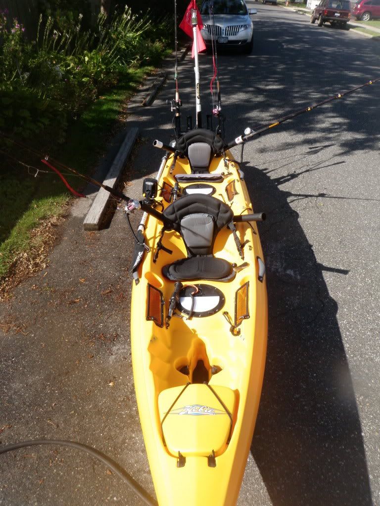

PostPosted: Sun Sep 18, 2011 3:06 pm
Joined: Sun Sep 14, 2008 9:09 pm
Posts: 187
Location: Sayville, NY
scfa wrote:
Any chance you can post a pic of 11 decked out?
Thanks
Here's some pics;
These are some of the extra's I've added Turbo fins, 'Cuda 350S ff/gps, (2)Scotty threaded flush mounts w/rocket launcher rod holders behind front seat, (2)Ram mount rod holders behind rear seat, PVC rod holder fits in Hobie flush rod holders, cutting boards mounted on front back hatch lids + extra padeyes to leash everything.
