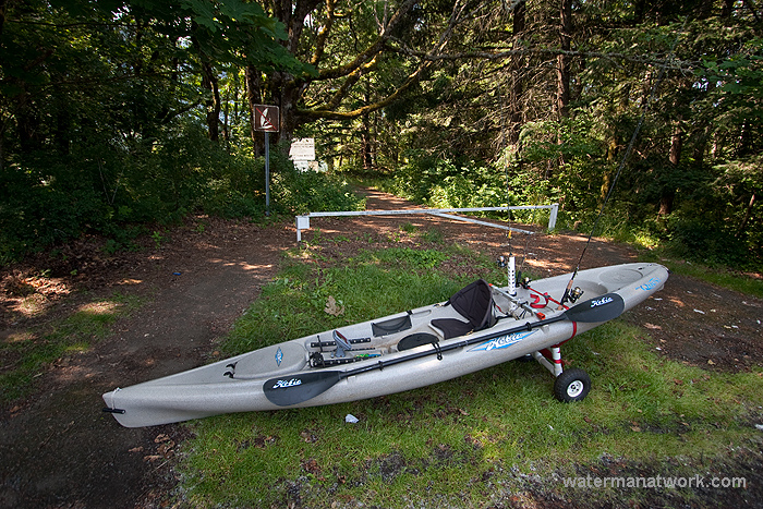

Personally, I would not tow a kayak on a kayak cart behind a powered vehicle. Too many things could go wrong. Bicycle? A loaded kayak seems a little heavy and awkward for a bike; you could fall and get hurt. Maybe one of those industrial strength tricycles.
I have to cart my kayak into some pretty rugged places; rocks, sand, forest blowdown, etc. I've been using the same basic PVC kayak cart for years and it's never let me down. Sometimes I worry about the amount of stress on the front clevis, but it shows no sign of damage or weakness.
Usually, I have to haul the kayak at least an eighth to a quarter mile, some places are nearly a mile hike away, morning transports are in the dark using a headlamp.
