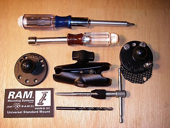

First off, here are the parts including the RAM Universal Standard Mount B-101. This is an excellent rig also for setting up a fish-finder on your gunwale or deck. The first thing I did was to enlarge the RAM standard mounting holes using a 7/32 drill bit.

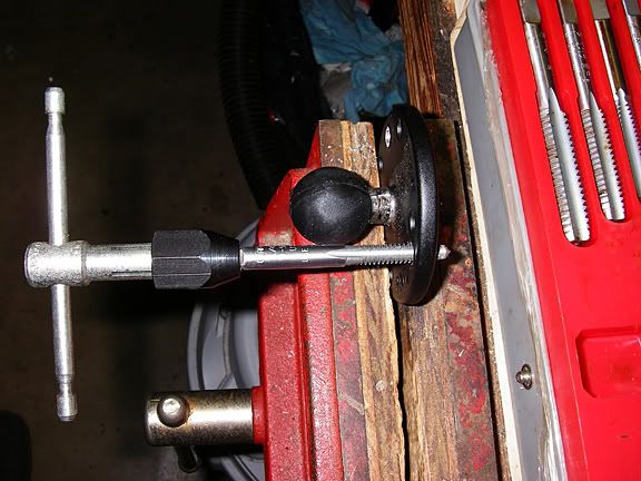

I then got out the ole tap and die set and threaded this hole with a 1/4-20 inch tap to take a 1/4-20 SS machine bolt to match the standard camera tripod mount.

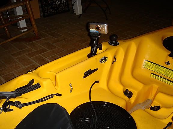

Here is the RAM Universal Mount with the first mounting option, in this case in the gunwale tackle tray.
If I had not already installed the larger RAM mount on the gunwale itself (at right in this pic) for my outriggers and rodholders, this would have been the preferred location for the camera mount, since water will collect in the gunnel tray and could leak into the hull. Note also the non-slip rubberized drawer liner material that I attached to the flat plate, using some Goop. The idea here is to cut down on possible slippage between the camera and RAM mounting plate.
P.S.: I should have mentioned that another possibility for mounting the flat base would be on the cockpit bulkhead just inside the gunnel tray. I would probably put it where the Ronstan cam cleat (or C-cleat) is now, and re-position this cleat further aft.
Here is a shot of the RAM Universal Standard Mount B-101 with the Pentax installed.
