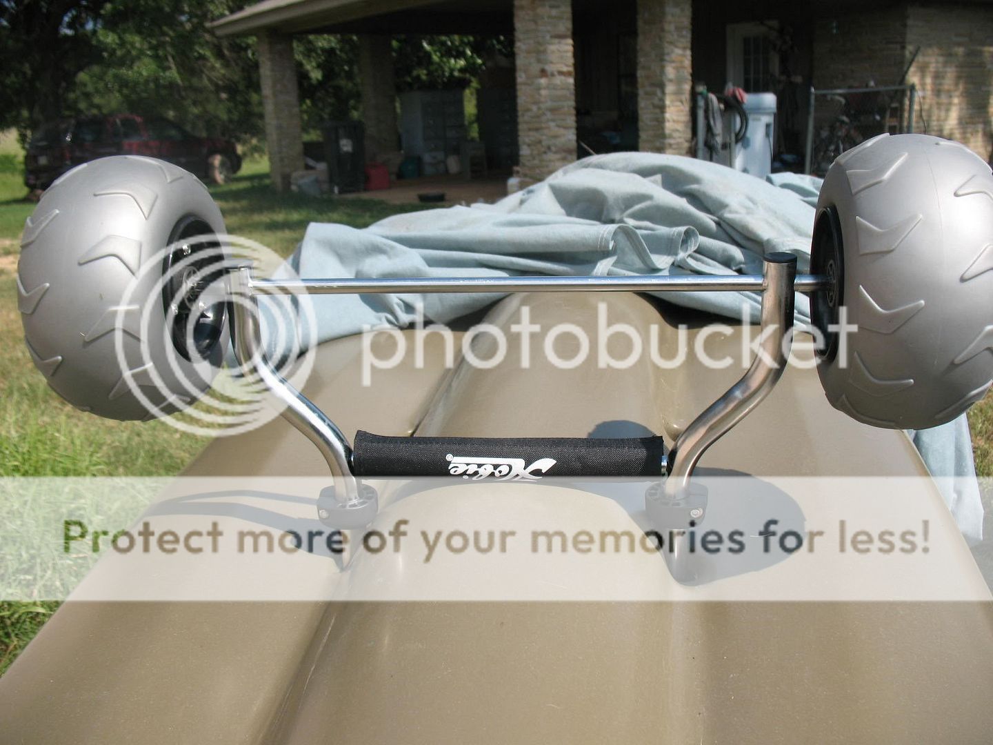

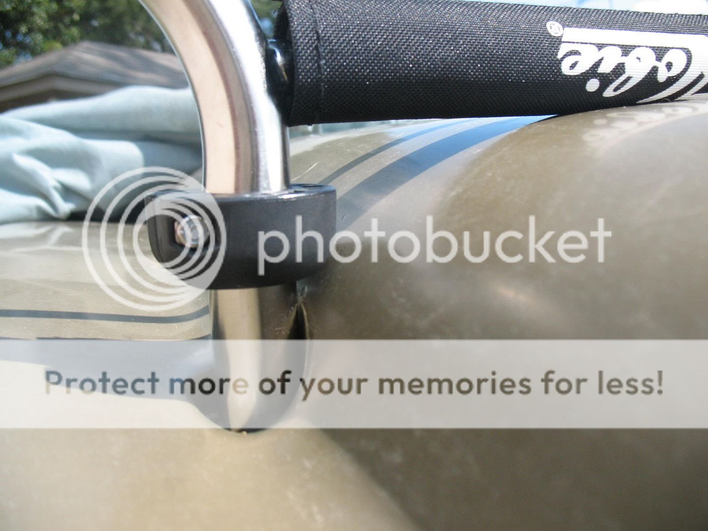

I got the Hobie Trax cart for use with my Outback. It came with the post bushings which are meant to take the weight of the boat off of the keel. The problem is these bushings only have a very small contact surface above the scupper hole when they are pushed down on the cart posts as far as they will go against the bottom of the boat. They are too wide to slide past the rounded keel to make a full surface contact. Should I be using these bushings with an Outback?

I have a new 09 Outback. You can see in Roadrunner's post that, without the tennis balls, the bushings would not make anywhere near a full surface contact with the hull when they are adjusted against the hull as far as they will go. In fact, the bushings only contact the hull over a very small area just below the scupper hole. Almost a point load when the bushings are used alone.

Here are photos as requested Matt.

Yep... thats no good. I like roadrunners solution.
