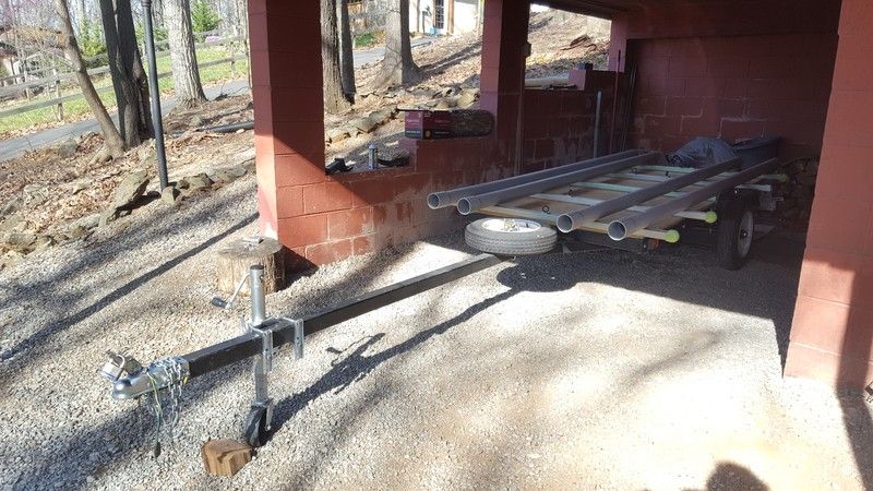

Wintersun wrote:
I have been using a Yakima trailer for our two Revo 13 kayaks and its one drawback is that it cannot go into the water. Jet ski trailers are few on the used market and seldom one that will take two jet ski's or two kayaks.
At this point in my life I value my time and do not want to invest a lot of time in converting a utility trailer and hoping for the best.
My question comes down to whether anyone is using a Malone or other off the shelf trailer for two Hobie kayaks and if it works well for submerging the trailer and float off the kayaks.
I have used submersible trailers with my inflatables and often had problems with getting them to float free when the boat was loaded with scuba tanks and do not want to get my truck's rear wheels into the salt water. The Malone kayak trailers look like the kayaks sit quite high above the ground which may not be a problem in getting the kayaks on or off with the trailer submerged.
We are in the same boat. I currently have a PA 14 and a Tarpon 160. The Tarpon is going to upgraded to an 2018 Outback in December. I did a few modifications in order to accomplish the design consideration of backing the kayaks into the water to float off.
1) Northern Tools 5x8 trailer
2) Extended the tongue
3) Bearing Buddy
4) Submersible tail lights
5) Plywood deck to raise the SuperStrut above the fenders
6) Eye bolts on the UniStrut for straps
7) Removed two leafs from the springs to reduce trailer bounce
We have made 2 - 1,850 mile trips and numerous local trips without any issues. If you have any questions, let me know. Hope this helps.
