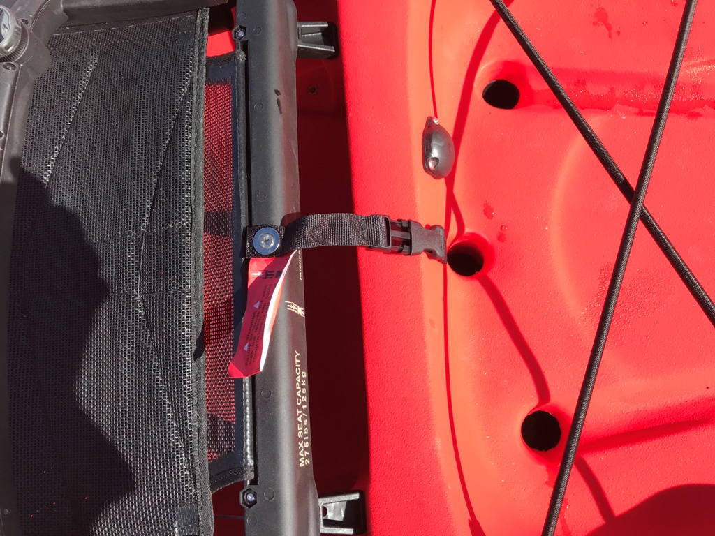

Sorry to resurrect an old thread, but has anyone else had an issue with the tether being too short to attach when using the kickstand? Matt?
This is on a 2017 Revolution 13 and I tried multiple seats and none had straps long enough to attach.
That looks like you're front x bar is all the way down - that will make the reach much longer - raise the front rail. Then they fit. You wouldn't sit in the chair that way - your seat bottom will be sloped down in front - not very comfortable. It needs to be the shorter length - if we make them long - then the chair can lift up in the back high enough to become detached from the front x bar. So it needs to be short by design.

PostPosted: Mon Mar 05, 2018 2:26 pm
Try what Jacques described... I suppose it iss possible that the anchor attachment locations have changed on the hulls. I have not heard that one before.
