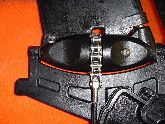

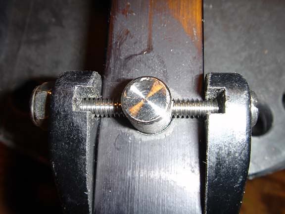

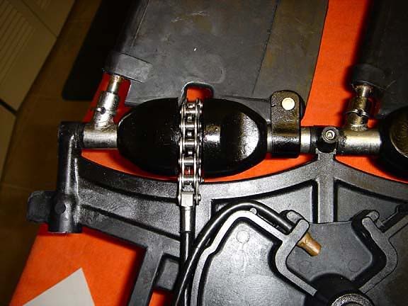

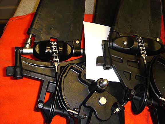

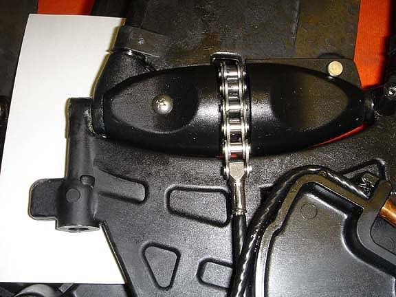

1. Here is a pic of both drives, with the 2004 drive to the left and the 2005 (new) drive at the right, fins up, forward part of drive (Pitot tube speedometer holder) to the left.
2. If you zoom in on the 2004 drive on the left above, you will note the stainless steel holders for the masts. Note also that the leading edge of each mast is secured by a SS cotter pin--no way the mast can become separated from the drive (unless the cotter pin breaks—unlikely unless it is non-SS and rusts!) since the cotter pin goes all the way thru both the holder and the mast itself. No use of set screws or "set points" anywhere here that are embedded in plastic that can break or become stripped and fail to hold the mast tight.
3. Here is the 2005 (to present) arrangement in which the former SS mast holders have been replaced by plastic, as has the steel sprocket beneath the new sprocket guards. So what we have now are plastic sprocket teeth (like the sprocket teeth on a bicycle pedal assembly) driving the steel chain that operates the fins on the Mirage Drive. Again this seems to be a potential source of trouble as more folks go to the Turbo fins and/or longer-term use of their drives. However, I have to say that I have not heard of any problems or complaints about this as yet (as of Feb., 2007).
4. Here is the opposite side of the newer drives (rear of drive to the left, fins up) showing how the after part of the fins is secured by SS pins that are held in place with a split ring-same as for the 2004 drive. This seems to be a simple, yet functional way to do this. The problem is in the forward attachment of the fins that are now using plastic and a SS screw insert to secure the masts in the newer drives.
