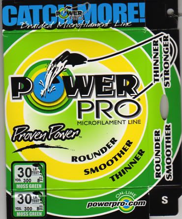

There is also another source for the Spectra lines--your local (or online) tackle shop. One of the most popular braided fishing lines out there at present is PowerPro. If you look closely at the packaging, youwill see that PowerPro fishing line is "100% Spectra fiber".
Now finding that line in the size that Hobie uses (say about 400 lb test, accordiing to Matt Miller) in a tackle shop would be an entirely different matter, but at least it is nice to know that there are other sources out there.

Apalach... a fellow yakker friend of mine (Larry- BigRed455) and I were talking about the fray on the back of my 2007 OB... he asked why couldn't the rudder lines be replaced with aircraft wire or line. (not sure what they call it). He said it would NEVER fray or break. Then he said.. why not Power Pro... laffin... :D Great minds think alike. lol I went out Sat and Sun with it like it is and it hasn't gotten any worst nor did it break. I'm wondering how hard is it to replace that one line. I might have to order 12-15' of it.. so I KNOW they will have it when I go in to get it replaced. :)
