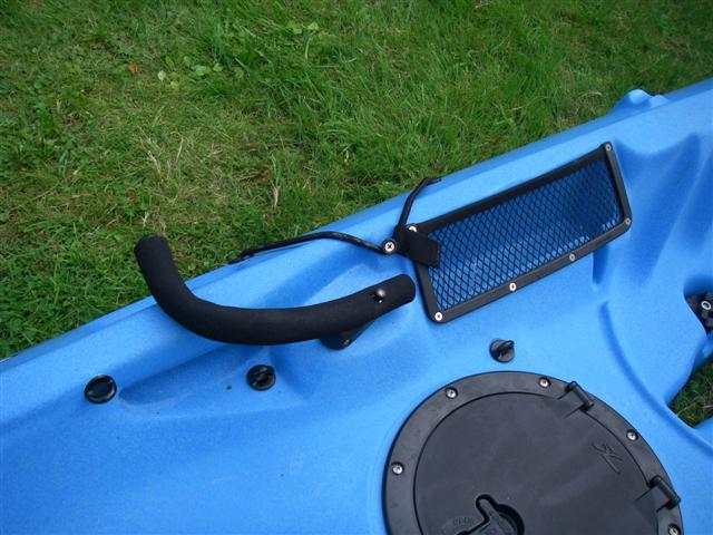

PostPosted: Tue Sep 18, 2007 1:45 pm
Joined: Wed Aug 15, 2007 1:23 pm
Posts: 10
I found grey electricity pipe. That made it much easier to make a handle just like obbm's example. It turned out that I tried to use water pipe, which is too wide and I could not bend it using a hair drier.
I also wrapped bicycle handle-bar foam around it. It is slightly too wide for the pipe, but it does not really matter when you are steering, and the grip is much better. This is the result:
Steering is so much more relaxed now! I wish Hobie would make parts like these for us!
