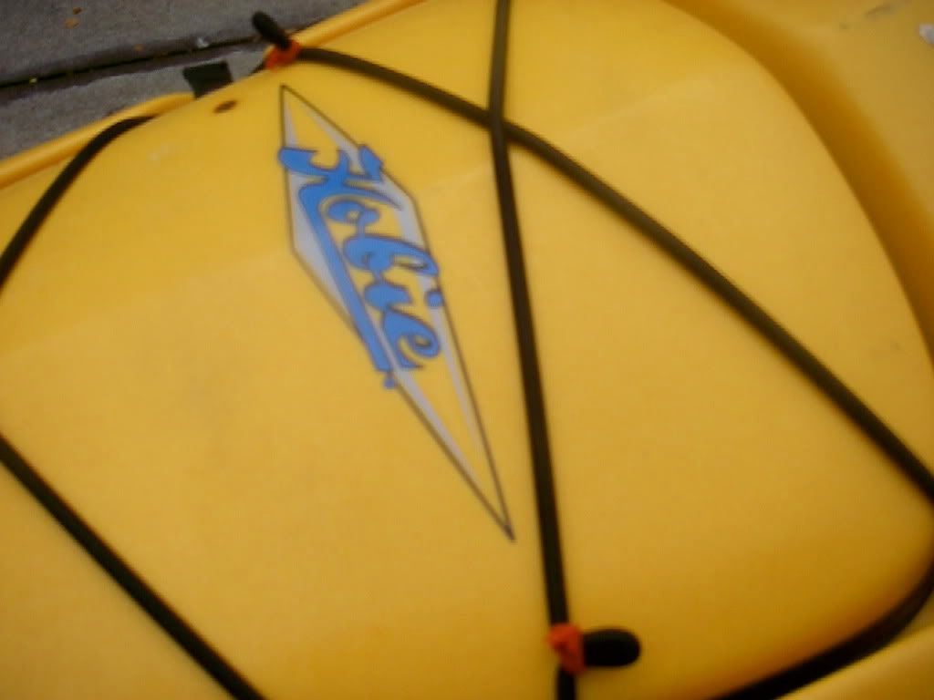

After test figured it wouldn't hurt to tighten up bungie cord which does get slack overtime. If you think your fwd hatch is leaking you might try this. Here's a pic of how I did it very quickly using two plastic ties.
