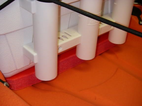

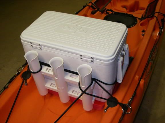

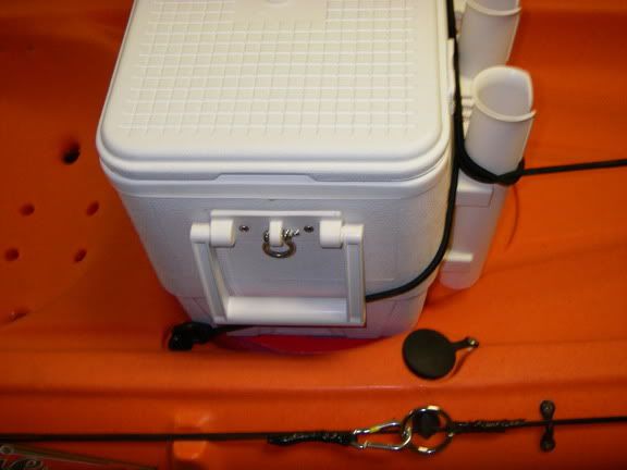

I had an old boogie board that I cut and shaped to fit in the forward section of the tankwell and placed the 25qt Igloo cooler on top of that. Raising the cooler several inches provided for a perfect fit and I then secured the cooler to the kayak using the shackle/bungee setup that Apalach devised.
see foam pad underneath the cooler
see shackle. I have a bungee clip that I attach from the shackle to the kayak.
