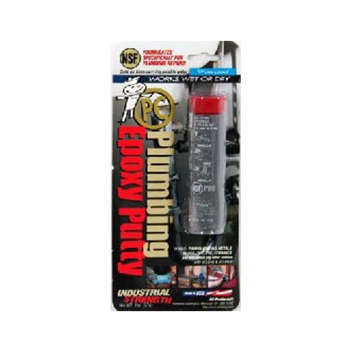

For what it's worth, and it remains to be seen it this will work at all, I referenced the 18 next to mine which has near perfect castings of the same vintage and used that as a baseline for what I hope will be a successful repair using Home Depot epoxy plumbers putty. Basically, I thoroughly cleaned the casting to the remove grease, dirt etc and applied the "Play-Doh"-like putty into the divots until it was smooth. I have my doubts the filler will hold but the entire repair only took me around 15 minutes at a cost of ~$5 so I figured it was worth a try. I have successfully used this stuff on other projects and it dries incredibly strong. We'll see. Here's the stuff I used.....

Okay, thanks. Wasn't sure about the grooves but figured if I built them up with the epoxy putty it might help improve the efficiency of the system by putting it back to "factory spec". If anything, the "runners" on the upper casting will run a tiny bit higher as the rudders come up. Would this in any way help free the rudders to kick up? I have no idea and, frankly, I don't intend to see - I'll be manually releasing the rudders as I approach the beach going forward (No rocks, sand bars or Oyster beds to contend with where I sail, so it really isn't that big of a deal).
