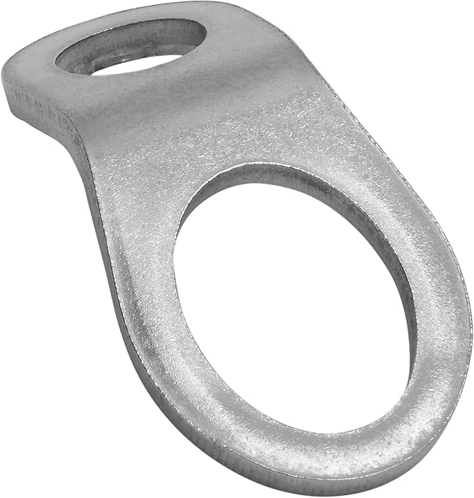

I really like the idea of attaching to those bolts/nuts, especially looking at the other option where drilling and riveting seems to be involved. I didn't actually have to take off any covers, there weren't any there. When I looked, it seemed like it would be a simple matter to unbolt the crossbar-hull bolt and attach something under the bolt head, but I'd rather not un-do any metal to fiberglass connections if I can avoid it. Plus, it looks like connecting there would put all the stress on one of the hull lips, instead of the crossbar. Connecting to the dolphin striker mounts seems like the ideal choice, since I'm already using the dolphin striker with my current setup.
I'm having trouble finding hardware to do this though, especially with the recessed dolphin striker nut. How much weight should this D-ring or what ever I end up using be able to support? Any suggestions for hardware? Ideally I'd like to find something that I can simply unbolt existing hardware, slide on new hardware, re-bolt old hardware back on. I'm not opposed to safe modifications or DIY hardware though.

As for hardware, I have lucked out and found a nearly perfect solution:
Its stainless steel and fits the dolphin striker mount without even needing to remove anything. I slid this over top of the existing lock nut then added an extra standard nut. There's just enough space so the bolt sticks out about 1 full thread, so I'm calling that good and keeping an eye on it (maybe some locktite later). The manufacturer claims it can hold 500lbs. Thinking if there's more than 500lbs there, somethings gone horribly wrong.
I will probably use a pair of shackles with Murrays VLS Double Braid 1/4" (same as trap adjustment lines) with bowlines connecting to the skippers trap lines for the leaning support lines. The bottom/crossbar shackles will also hold the gin pole lines. The trap lines will have enough slack to allow the mast to swing so that the mast head can move to 1/2 way between center-line and the inside of each hull. speed mentioned that those lines will get tighter as the mast goes up (my current setup loosens). Is this enough slack?
I also plan to switch from using the forstay to both crew trap wires, assuming that wont cause a problem with using the other trap wires too. That should resolve the issues with pinning the forstay.
Thanks for all the advice, suggestions, and links so far. Anyone see any problems with this setup? Am I missing anything?
Sounds right. You will know for sure when you raise the mast.
A couple more tips:
When attaching the crossbar to the trap wires, attach to the wire eye loop, not the adjustable ring on the trap wire. This way adjusting the trapeze height won't mess up your mast stepper.
Use the same rope to stabilize the gin pole and hold the trap wires stabilizing the mast. The rigging should go like this: Eye snap on the end of the trap wire - short length of rope - eye snap to dolphin striker nut hook thing - several feet of rope - bowline to tip of gin pole. Repeat for other side.
