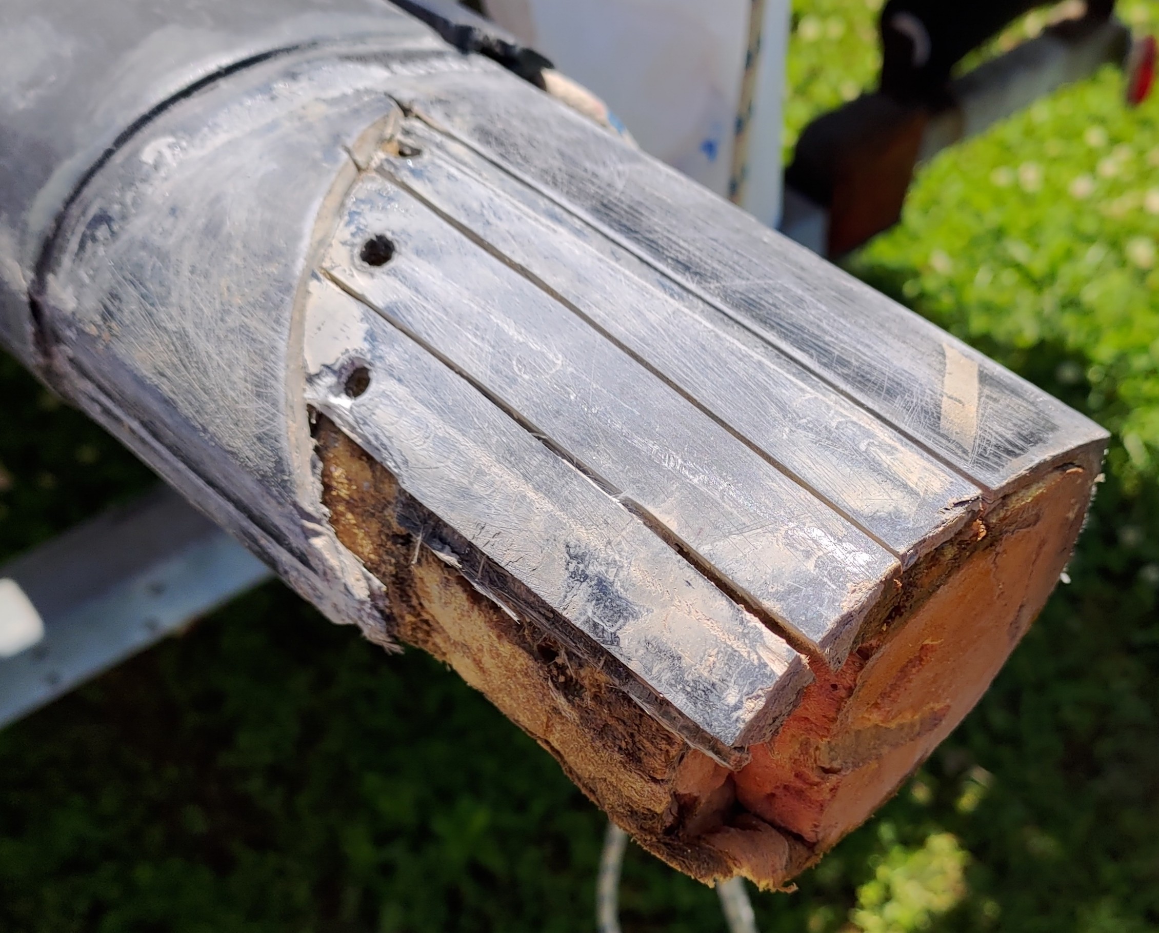

I got a little more done with this today. The peices still stuck in the mast are out now and it gave me a new approach. Instead of just building a sleeve inside the tip, I have shaved down the foam plug that was stuck in the mast , so that i can repair the cutouts and recess them so that they will smoothly fit inside the screw heads holding the tang on. I'll be repairing the base of the tip with standard poly fiberglass resin and cloth, much like I intended to build the inner sleeve. I think it will be much easier to do it like this, and probably a bit stronger too.
After the repair, I'll be following the rest of the previous plan, coating the mating surfaces and filling the recessed slots with marine JB. The hope is that the JB will surround and fill the screw heads, which are actually security heads (T-bit/star-bit), not phillips as I first thought.
Here is a pic of the peices recovered from inside the mast, which has been replaced on the comptip. It has not been cleaned, trimmed or repaired yet in this pic, just slid together.
Its still not pretty, and the bow side still needs to be completely rebuilt (fell apart as I took it out of the mast) but I think im better off than before. Weather permitting, I plan to have the repair done tomorrow, then the reinstallation the day after.

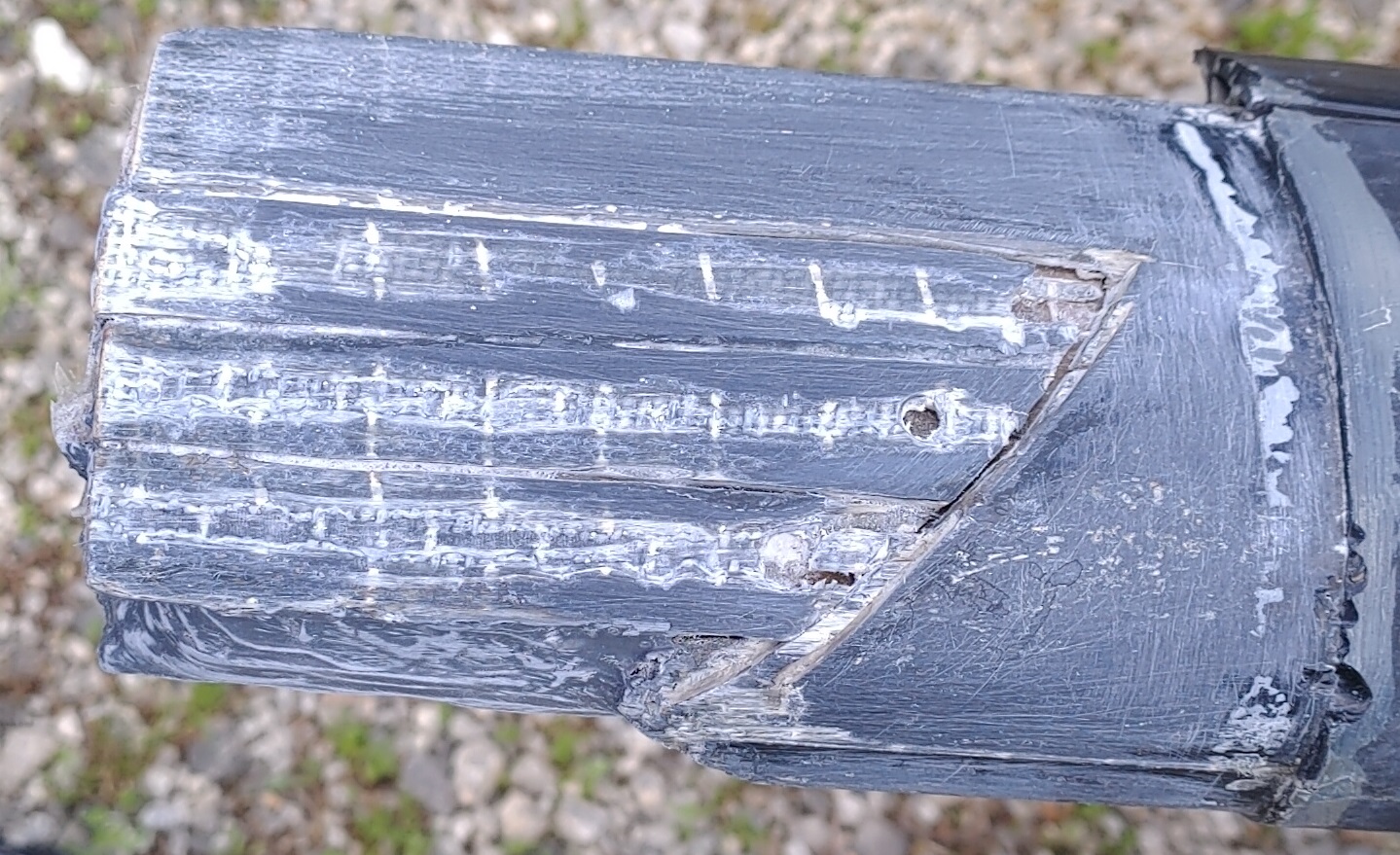

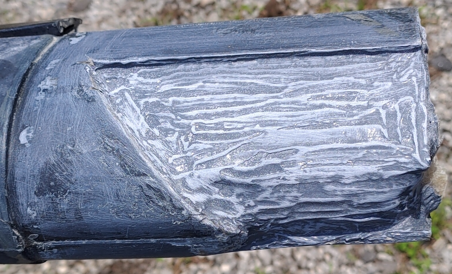

I have finished the installation. It went about as expected. I coated the inside of the extruded mast section and the outside of the comptip insert section, as well as filling in the recessed areas as mentioned previously. I probably went a bit overboard, using all of the marine jb weld I had left and probably close to an ounce worth squeezed out and onto the ground. Better too much than not enough I guess. I think it will hold nicely, at least through the season, maybe longer. Though, I don't plan on testing it if I can find a replacement mast close-ish.
Really, the hardest part of this step was getting the main halyard back through the mast head, though I think some of that was my fault, the end of halyard was a bit frayed and I didn't melt it before feeding it through. Now is the even harder part, waiting... It's a beautiful day (finally), the jb has set, but I still need to wait for it to cure. Here's hoping its just as pretty tomorrow and my crew is available.
Here are some pics after the repair, but about 1/2 way through sanding the partially filled section from yesterday. All of the holes and spaces got completely filled with jb. they would have been filled with fiberglass resin with some shredded mat/cloth mixed in, but I used the last of the resin I had for the rest of the repair and it set before I could get to that part. I don't think it will be a problem though. At the stage of these pics, that whole area is rock solid and wouldn't budge by hand, and I TRIED to break it. My only concern is that normally, there would be rivets holding it in (the mast tang rivets) and the only thing holding this comptip in is the jb. Do you guys think that will be enough? or would you suggest I drill a couple/few holes and add some rivets? I was afraid of weakening everything by drilling holes, so I didn't, and don't plan to unless someone with more experience with comptips thinks its necessary. Again, this is only really meant to last the rest of the season, or until I can find a nearby mast.
I'll give another update after a few sails to let everyone know how it holds up.
