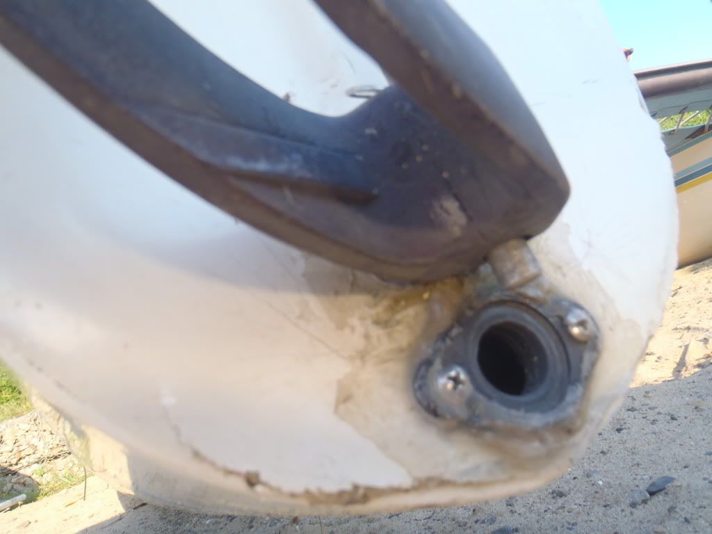

Went back to the cat tonight.
Finally, with day light, it was a lot easier to see the problem.
There is a crack at the back of the hull, from the middle to ¼ of the way up, where the hull ends and the side where the plug is, both intersects.
I guess I'll read on the forums and fiberglass this part...
From your experiences, in what time will I be able to put the cat back in water? I would like to make a quick fix (if possible) and work harder on the hull during winter (in Québec, season is short and hope I can get the most out of it).
Thanks,
JF

There are guys who I am sure will give you more specific info than I can on this, but because this is in the transom area there are a lot of forces back there due the the rudders. A quick fix that only cures the leak may not take care of the real problem which is structural.
The fiberglass work will need to strengthen the transom area.
If you can post pictures of the crack to this site this will go a long way to getting the best advice on what to do.

First a pic would really help.
You will need to glass from the inside. Cut an access port in the rear deck for an additional porthole. Sand the area for about 3 inches on all sides of the cracks. Drill the ends of the cracks with a small drill. A small hole at the end of the crack will stop it from continuing. Glass the cracks with 6 inch strips of fiberglass matt and polyester resin. Atleast 3 strips on both cracks. If the crack intersect alternate the strips so the center has 6 layers minimum.
If you tape the outside before starting the glass and resin work(blue painters tape works well) you will have minimal clean up to do when finished on the hull. A little gell coat on the crack and drill holes and your back on the water.

Finally, here are some pictures of the cat...
if possible, i would like to fix the boat as soon as possible with a quick fix. Boat is currently at the beach and I would like to work from there.
I would work on the hull this winter.
any ideas? here are some pictures, any help would be appriciated.
