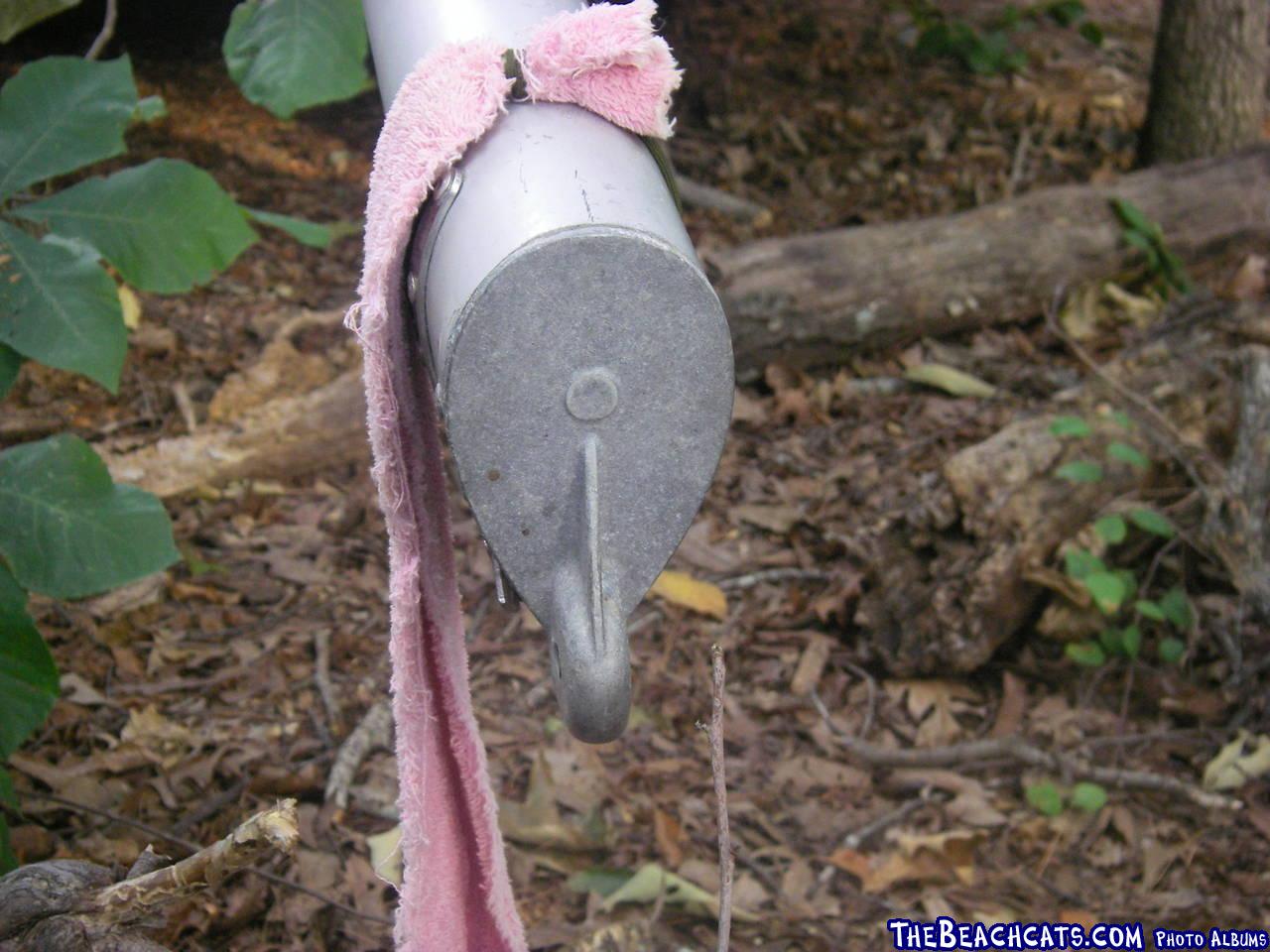

at the top of the mast where the main sheet halyard enters the mast itself, I do not have a rotating pulley, but a flat thing which makes raising the main sail a pain. Is this the design, or is mine broken?? If broken, can it be replaced?

Thanks for the quick answer... but .. Nope, I know the flopper, that was what covered the thing which hooked the ring and held the sail up on old 18's.... this is where the halyard itself enters the mast to return to the bottom for hoisting. The halyard makes a 180 degree turn over this flat thing and disappears into the mast. It seems obvious to me that it should be a pulley, but then this is the company that designed the flapper and the system of holding up the main sail 30 feet above the deck in the first place.... so, is it designed to be a flat immovable object, or should it be a pulley? If a pulley, then mine has jammed some time ago and has worn flat and needs to be replaced. Can it be replaced? What part would I order to replace it?

It is supposed to have a pulley. You should see a pin or axel that would be removed to re-install a pulley. I assume you have an older H18 Pre-Comptip? May be the same pulley though. Check the parts diagrams.

Here is a few photos of the mast head for H-18. You Can clearly see where the main halyard mast head sheeve is located. Hop this helps. (from THE BEACHCATS )
Comp-Tip Mast
And from an all aluminum mast:

Thanks.. that's what I needed to know.. (It's an SX about 6 years old..).
