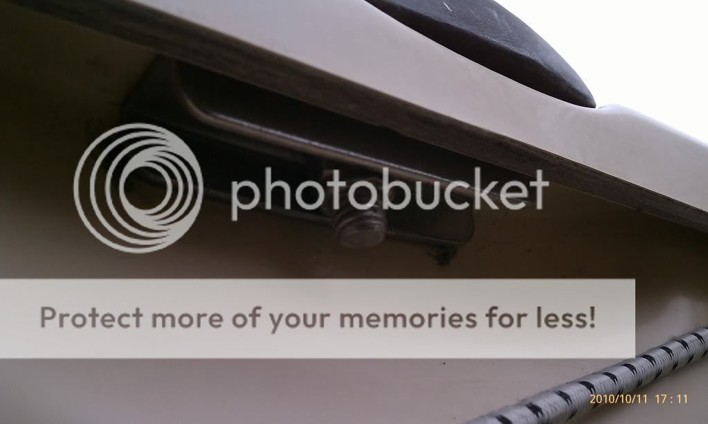

I'm not sure but I believe you need to upgrade your boat - especially with the wings (Matt would know for sure). The spot where the crossbars mount to the hulls needs a larger bracket or the hulls can fail (crack and sink !) If you search 'redline' boats then you will find it.
Here is my boat - with a small piece of channel shaped anchor bracket under the lip. I need to upgrade too !!
Here is a boat with the upgraded bracket installed - they are the same as your side stay anchors.
Front:
Rear:
If i'm mistaken on this please correct me !!??
I just ordered the brackets myself.
Mike
