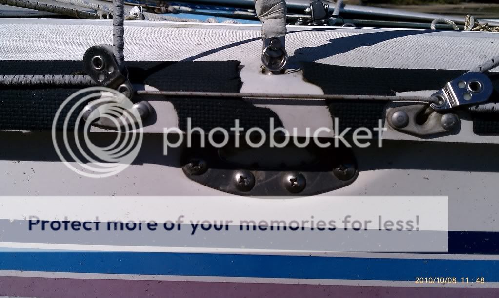

I saw a boat setup with blocks to reduce friction for pulling out shock cord for trapping. The setup below is what i saw. Are there any other ways to get this done ? I will be using the Harken micro blocks as seen below. I think the setup is good just wondering if there's a better way.
Thanks.
The setup i saw had a line tied through the two shock cord ports with blocks attached to it.

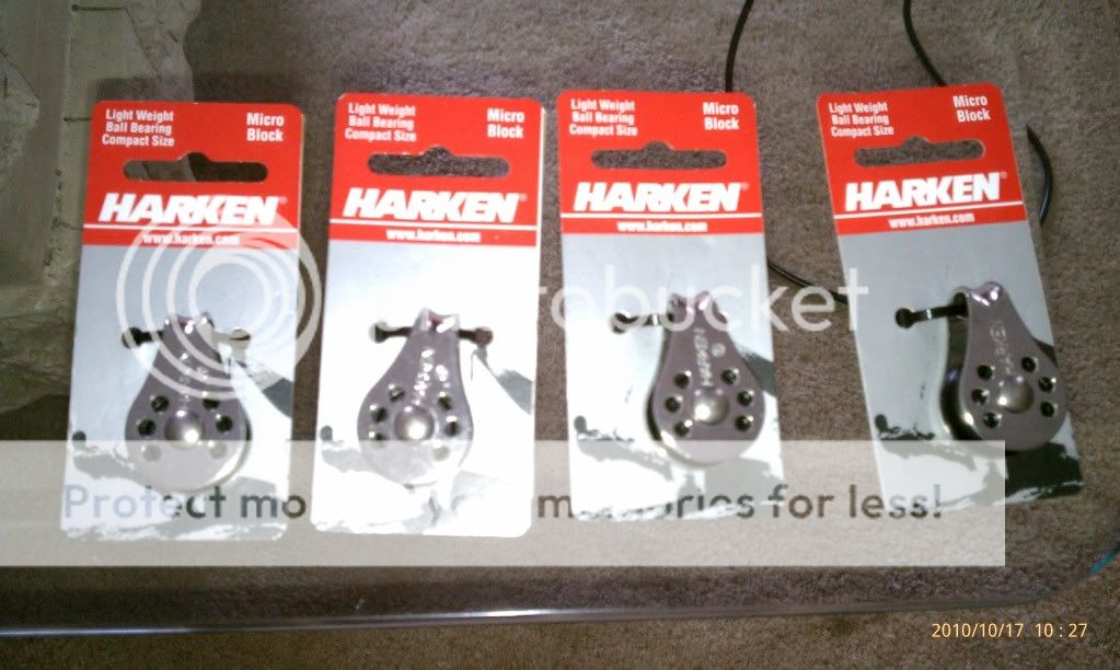

The blocks i bought:

If you research my posts you will find that I have posted a trapeze system very similiar to what you have there ..... except ...
1) I tie the two blocks together w/ 1/8" spectra/vectra UNDER the gunwale ....and I have micro blocks tied fore and aft at the padeyes under the gunwale also ....
Now w/ approx 25' of 3/16 bungie start w/ the crew/fore trap ... tie the bungie there ... run through the micro block tied at the gunwale ... go forward to the micro block there .... thread through (bottom to top) .... and go all the way to the aft microblock tied under the gunwale ... thread through that block (top to bottom) ... return to the micro block tie at the skipper's trap ... thread through it ... and tie of to the skipper's trap. Now you have a continious bungie trap system that works w/ both a H18 w/ magnum wings or a standard "SE" H18 w/ lots of stretch available for traping out ...particulary when trapped very far aft on a screaming reach.
Oh ... see that clevis pin w/ ring attaching the side stay/shroud to the "anchor pin" in the middle of the picture????
Do one of two things ... before you lose it and de-mast!!!!!!!!
1) TAPE THAT RING WITH RIGGING/ELECTRIC TAPE
2) Re-place that pin w/ a shackle w/ a captive pin that can not come out. (I sometimes rig a "barberhauler" to that shackle ... not class legal for racing but does shape the jib nicely for reaches when "fun" sailing)

Harry,
Thank you so much for the information. The boat in the picture isn't mine - i don't know who owns it ?! I saw it and noticed the upgrade and took a picture.
How did you tie the micro blocks to the boat ? You lost me on the description - i read it and tried to figure it out...Any chance you could post a picture ? A picture is worth a thousand words !

1) (8) Small Blocks divided into (4/side): Best- (4) Harkin "Micro" blocks and (4) Harkin "Air" blocks or just (8) total "Micro" blocks.
2) Approx 50ft of 3/16 bungie cord (25ft/side)
3) 1/8" Spectr/vectra cut into (4) 1ft lg pieces, and (2) 2ft lg pieces.
The Harkin "Micro" blocks are perfect for the (4) blocks that you attach to the padeyes under the gunwales using (4) 1ft lg pieces of spectra/vectra of line that are located near both bows and both sterns. You will find that the "Micro" blocks fit/tuck snugly up under the gunwale after you "lace" the 3/16" bungie cord ... but, I like either the Harkin "Air/Micro" blocks because they have ballbearings w/ a metal housing that as you step on/stomp when "traped out" will not break .... the "Air" blocks are just slightly smaller and therefore there is slightly less "under foot" at the mid-ship gunwale fairlead location(s), both will work, Ok?
Next, Using the 2ft long pieces of spectra/vectra ... tie the "Air" (or "Micro") blocks at the gunwale fairleads for the trapeze system. I loop the line, w/ the Harkin blocks on the outside of the gunwale through both fairleads and tie the two ends together so all the line, and knot, is tucked up under the gunwale w/ the blocks on the outside of the gunwale, on small loops w/ the smallest/shortest/tightest length of line possible. (The first time I did this I spliced 1ft pigtails of 1/4" 3-strand to each block ... fed that through the fairleads and tied the two ends together ... pulling against each other .... looped 1/8" spectra/vectra w/ knots is a little easier and quicker ....)

That's a perfect diagram of the system I installed on my boat ..... and SRM is quite correct that it is NOT class legal.
The non-class legal part/issue is that the bungie cord does not feed/pass through the actual fairlead .... I believe the intent of the rule is not to be able to re-locate the trap wires .... by attaching the "Air/Micro" blocks as tightly as possible I believe I'm not violating the "intent" of the rule ... but only making the trapeze system fully functional.
As I also have a set of Magnum Wings that I take on and off constantly, and I was tired changing my trapeze system, I experimented w/ this idea and it works well. Some of the guys said that if I ever got my procrastinating butt in gear they would support a rules change to allow this "upgrade". But since the H18 is a International Class all rules changes must be approved by the IHCA .... that's too much bureacracy/paperwork for me to deal w/.
