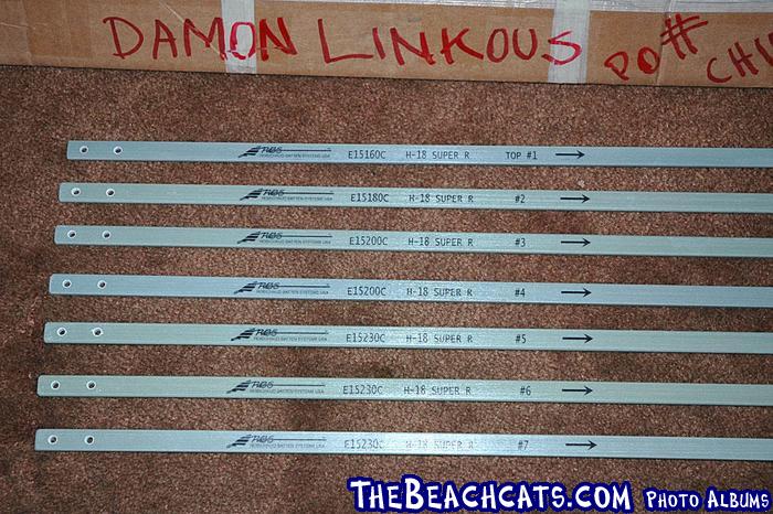

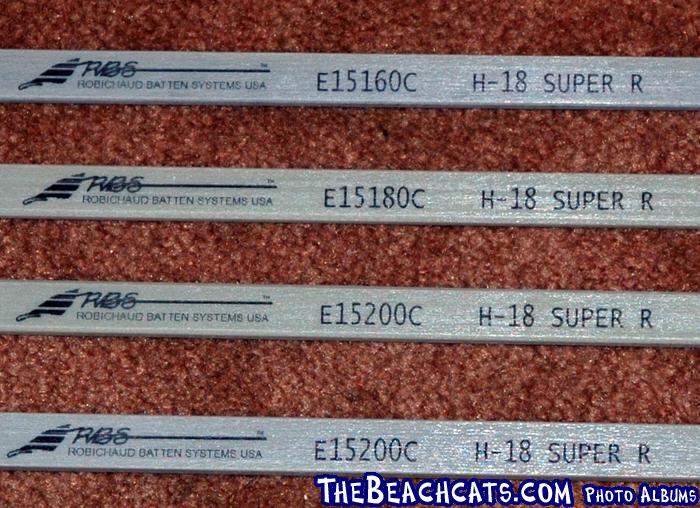

RobPatt wrote:
What battens do you use w/the squaretop pentex? Stiff old hobies, or did get you new and do you think THEY make any difference?
Yes, new battens for the new sail.
http://www.thebeachcats.com/pictures/?g2_itemId=15026
The new battens were e-glass from RBS Batten Systems
http://www.rbsbattens.com/
I bought them from Whirlwind with the sail, Chip matched the bend characteristics to the sail so the shape sets correctly.
