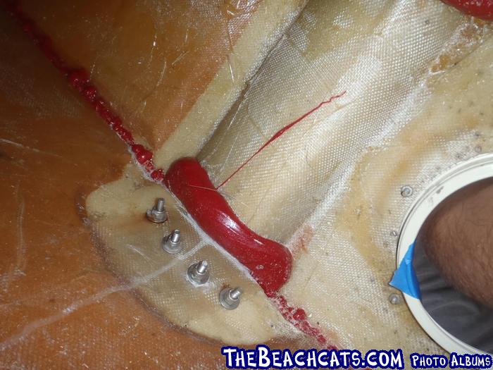

84 means she probably a red line boat. For a few years the boats were built lighter but weaker and prone to failure at the fwd crossbar anchor plate.
The repair involves reaching your arm in the boat and adding a few layers of glass to anchor plate area, it also involves a lot of sanding. Here a link to how I did mine.
http://www.thebeachcats.com/pictures/?g2_itemId=86607
Id replace all the shock cords along with the standing rigging. Also Id attach the mast base plate to the crossbar with some weld all epoxy or something similar.

A Redline boat was built using red glue to join the deck with the hull. Inside the boat you can see a red bead of glue around the seam, outside the boat on the seam which is the underside of the deck lip you can see a thin red line right down the middle of the seam.
The hardest part of the job is grinding away the red bead of glue, its hard stuff and its really hard to do with one arm and without being able to see it, touch only. I used a really raspy rasp for most of it a grinder for some and 60 grit paper for the rest. My biceps grew about an inch.
The weakness aint really a problem unless your doing prolonged wave jumping with two or three heavy adults, I did mine so if I did want to go wave jumping I could. Also check all your crossbar anchor plates and the plate that wraps around the furler where the forstay meets up with the bow tangs for cracks.
