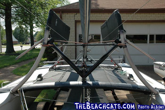

In your trailer-tie-down picture it looks like you are folding your wings against the mast. If so and you trailer any distance you get damage from rubbing, especially the diamond wires cutting into the wings.
Make something like these to hold the wings upright away from the mast.
http://thebeachcats.com/pictures/?g2_itemId=11711
