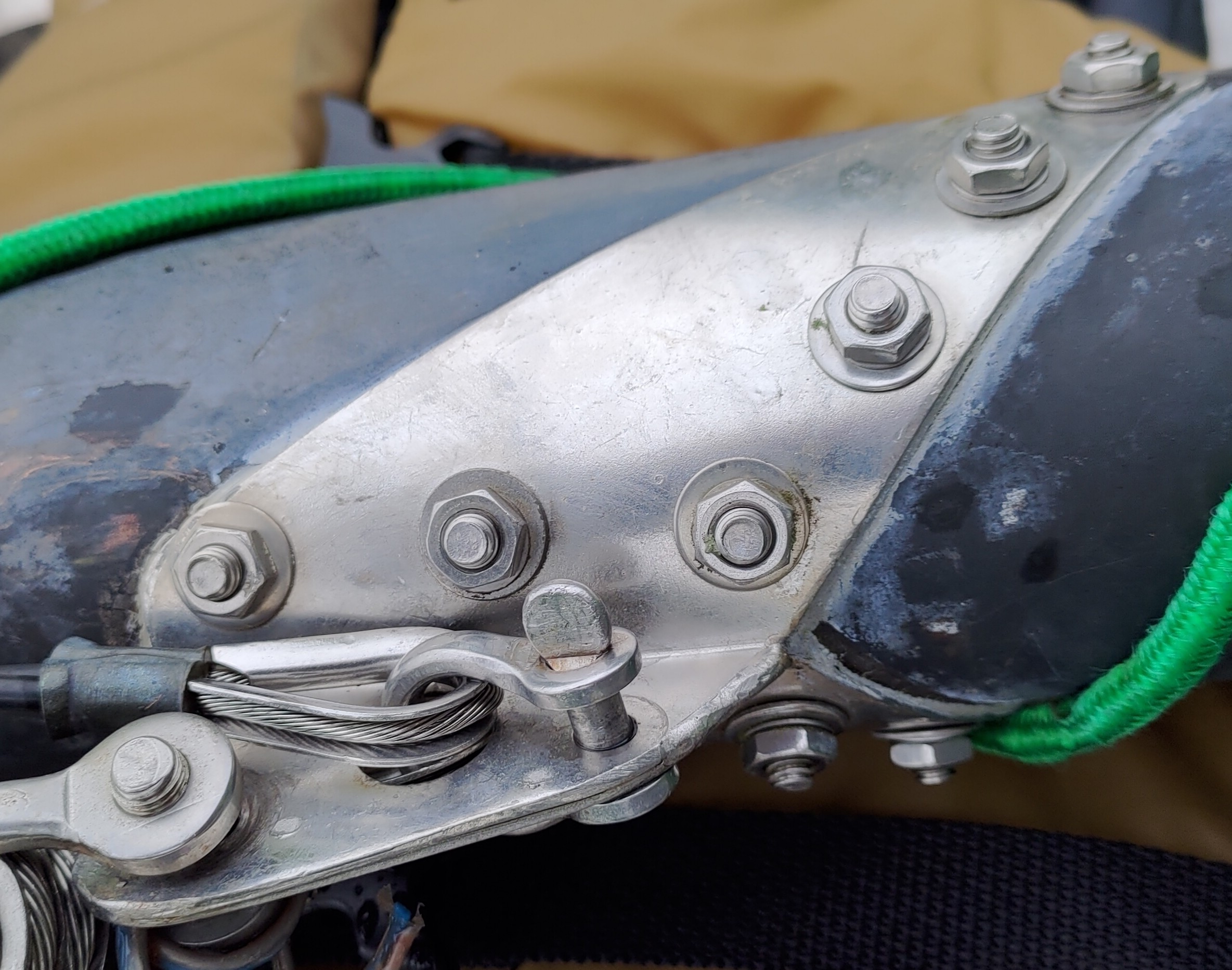

Here for s a pic of my tang.
Standard Hobie 18
PostPosted: Thu May 21, 2020 9:58 am
Posts: 4304
Gotta say, that one’s a bit baffling. Not sure how the screws would have been installed from the inside of the comptip.
So if you try to tighten the nuts, the whole screw just turns?
Only thing I can think is maybe the previous owner slotted the holes for the comptip or just ground away channels where the screw heads protrude into the mast. Then they would have been able to install the screws and then slide the comptip in over the screws. That would also explain why you’re able to slide the comptip in and out a few inches.

I haven't actually tried to seriously turn the nuts, other than a finger check to make sure they were secure. They did not spin at all by fingers and the tang has no play or wiggle.
Given that the tang and bolts are secure, and the comptip is not, I suspect that the bolts are not actually going through the comptip. I think the tip may just have slots cut/drilled to accommodate the bolt heads, hence the sliding and wiggling. How far does the comptip go into the mast when properly installed? Any thoughts on drilling a couple extra holes for rivits to better secure the tip? In addition to bondo, and after complete removal and reinstalation of the tip (if removal is necessary and/or worth the risk).

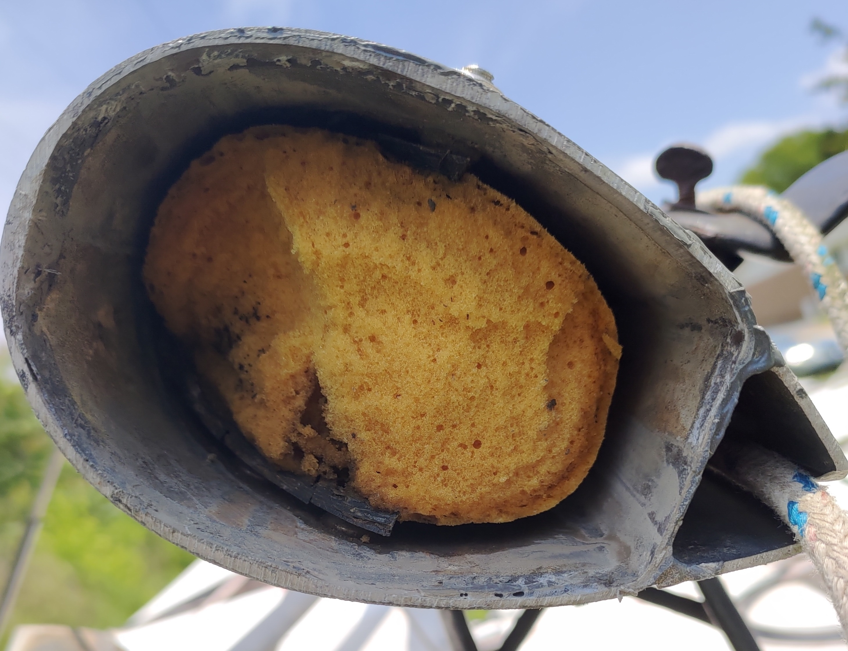

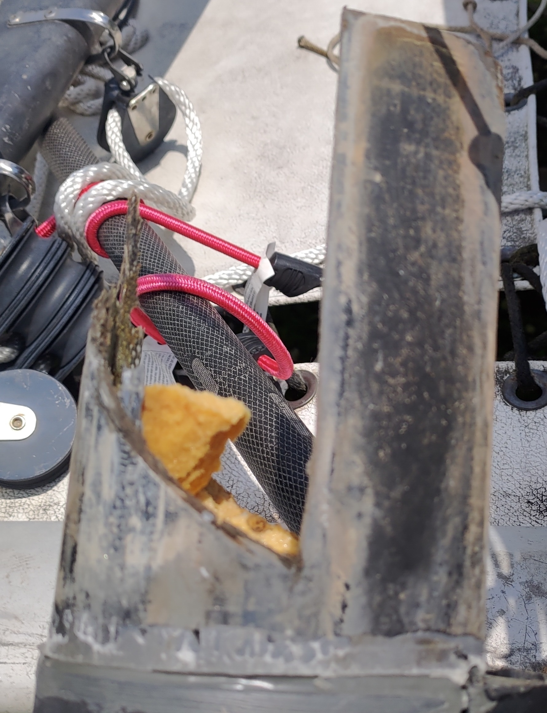

The weather agreed it was time to get started, so I did. The news is not good. The good news is that the tip came out easily. Unfortunately, that's also the start of the bad news. I did not have to remove the tang bolts to get the tip off. Those bolts were not supporting the tip at all. In fact, nothing was. Its almost worst case scenario.
The last owner (or who ever installed the tip) basically just cut off large sections of the tip to make it fit around the tang bolts, which are just round top, philips head machine screws. It looks like the cut off peices are still in the mast, but I cannot get them to come out, they are in there good. Since replacing the tip basically means I'll go ahead and replace the whole mast, im going to attempt a repair on this one first considering I have everything I plan to use for the repair left over from other projects. If it doesnt work, I should only lose time.
Here's some pics:
The plan is to thoroughly clean the mating surfaces. Lightly sand with 80 grit to give a better surface for adhesion and use marine jb to fill the gap and glue it together. I wanted to use bondo as recommended almost everywhere, but given the limited surface area, I thought it would be better to use an actual adhesive, and I already have the jb.
After the jb sets, I may use some carefully placed rivits to help hold it. This would mean drilling more holes in the already limited surface area though. Anyone have thoughts on this for either yes/no or best locations and number of rivits? Im an electronic engineer, not structural, so I'd almost be guessing.
More updates to come once the JB sets.
Kyrle

No amount of JB Weld is going to fix that. Hard to tell exactly what happened from the pictures. Looks like they forced the comptip past the screw heads, potentially cracking the comptip which then broke off. Anyway, I highly doubt glueing the tip in with JB Weld will provide a lasting repair or hold up to any significant load. It would need to be fixed with fiberglass and possibly an internal sleeve.
I’d start searching ebay and craigslist for a used comptip or mast.

I am located near Greenville, SC. The only broken part is the bow side of the comptip, the rest (V-slots) is actually cut to accommodate the bolts.
I have some fiberglass left over from a minor hull reinforcement. Since I haven't started actually reattaching the tip yet (thank you rain), I may try some force to take out the parts of the tip still stuck in the mast and attempt to build an inner sleeve in the tip and rebuild the broken part on the bow side, but I doubt I'll be able to repair the cut outs without totally redoing how the tang is attached. Im not sure how I'd get it reattached if I totally fixed the the cutouts, as I'd have no way to access the bolts from the inside and I don't have the equipment to replace the bolts with large enough rivits.
So with your comment in mind, im now thinking I should clean the remaining comptip out of the mast, build a thick sleeve inside the comptip lower section (with fiberglass cloth and poly resin, well past the insertion point) then fill the slotted section ( which will have a fiberglass sleeve under the slots) with marine jb, along with coating the comptip and inside of the mast, then reassemble before the jb sets. Possibly adding some rivits for extra support.
It will never be re-repairable again, but at this point, im just looking to get through the season while I find a complete mast replacement (preferrably a full one-piece). I did some checking before I started and the closest I could find was a mast in New Jersey. Im hoping someone will be selling a mast or a complete-ish parts boat in the myrtle beach area, pretty sure there are many cats in that area.
