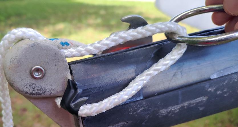

EDIT: I had a chance to get to the boat and get a pic to better explain what I'm considering. In the process, I kind of discovered the answer to my last question: Unless someone knows of a suitably small and strong pulley, it doesn't look like adding a pulley will work, I don't think there is enough room.
Some notes on the image:
- The white line is not my halyard, the grey and blue one is. The white line is what I plan to do (assume it would go into the mast head, rather than over it at the pulley).
- The electrical tape is just there to hold the line in place for the picture. My best idea right now is to drill a hole where the white line ends, right in that corner where the white line ends, just barely big enough for the halyard. The halyard would go through the hole and have a stop knot on the other side.
- With this configuration, I would be replacing the halyard with a smaller but stronger line and something slick, probably 5mm dyneema. Any suggestions for a better line would be appreciated, I chose dyneema because of my dyneema trampoline lines which are pretty slick.
- Yes, that ring is smaller, its actually a spare trap ring. It was easier to use that than to remove the halyard ring (that knot is TIGHT).

Not saying it won’t work, but you would probably be the first person to try this. I could see this potentially impacting how easy it is to hook and unhook the halyard. I also wonder if the friction of the halyard running through the ring would negate any mechanical advantage. Only one way to find out I suppose. Another thought for tying off the halyard end would be to drill out the rivet for the mast head sheave and attach a tang like this. You could just use a stainless bolt and nut to attach. This would keep both halyard lines better lined up with the original location and eliminate the need to drill holes in the casting.
https://www.westmarine.com/buy/schaefer--dead-end-bails--P002_060_007_537?recordNum=2
Personally, I would make sure you’ve exhaused all other options first. Make sure the boat is directly head to wind when hoisting. Use a 1/4” diameter halyard line. Battens not too tight. Lots of lube on the track AND boltrope. Use a handle on the halyard that you can grip with two hands and pull from directly behind the boat on centerline- two hands on the halyard, one foot braced on the rear crossbar.
Otherwise, let us know how it works out.

I am interested to hear your results if you do attempt a 2:1 halyard. I’m thinking this could possibly be useful with reefing the mainsail. The 2:1 purchase would potentially reduce the amount that the sail would creep down the mast under load if the halyard were cleated (rather than hooked) while reefing. I was also looking at the mast head on my boat earlier today and I think you could possibly drill out the rivet for the mast head sheave and install a shackle there (might have to bend it open a little and use a bolt rather than the standard pin). This would give you a tie off point for the halyard that was directly on the centerline of the mast, so less likely to affect the ability to engage and disengage the ring on the hook.

I wasn't able to find a dead end bail of a suitable size, but the shackle idea seems promising. I think I found the perfect shackle that wouldn't require any modification to work, so I'll probably go that route. https://www.tulsachain.com/screw-pin-wide-d-shackle-stainless-steel.html?utm_medium=ppc&utm_source=adwords&gclid=EAIaIQobChMI4dG0xdjt6gIVuey1Ch2a_QWuEAQYAiABEgJOF_D_BwE the 1/4" seems to be the perfect size and has a working load of 750lbs. That should be strong enough right?

Thanks for that info. Since I'd likely be going with the shackle idea presented by sm, I probably wont be using a stopper knot. Per your suggestion, I'll go with a small eye-splice to connect the dyneema line to the shackle. Guess I need to learn a new skill, I've never spliced line before...
I've been trying to do some research on it, but its not a popular topic apparently: Are there any other slippery rope types I should be looking at for this? It seems dyneema is a good choice (for friction), but is overkill really (for strength). That's not a problem, but I'd be paying a premium for the extra strength that I don't really need. I'm looking at just under $100 for this single halyard line (~90 feet @ $1 per foot + shipping). If I can find a less expensive alternative (or dyneema source), I'd be much happier.
Even if I get this sorted before resorting to the 2:1 system, I may go ahead with it anyways. When I suggested the change to my crew, the answer was an emphatic "YES!". There also seems to be other applications and interest. I'd love to give back to the community that has helped me so much with my 18, with this small contribution.

It has taken a while, but I'm finally getting around to setting this up. Using all of the suggestions here has helped a small amount, but the problem persists. For anyone wondering (seems to be a big debate on other forums), I didn't notice a difference between Teflon and silicon lube. Either was much better than none however. I never noticed a specific spot it suddenly got more difficult at, it has always been more gradual, but I did put the boat on its side and try anyways. It wasn't much help since there isn't a specific spot it gets stuck at and I couldn't find any pinching or problem spots. It was easier (aside from being awkward) to 'raise' the sail on its side though. I have the parts ordered (shackle linked previously and 5mm dyneema single braid), but still need some tools and some recommendations.
First, does anyone have recommendations for a decent fid set that they use? I'm looking for something good but not expensive. I don't need a professional set and would like to avoid a bottom of the barrel set.
Second, what type of splice would be best to connect to the shackle I'm putting through the sheave? I was looking at a Brummel lock, but have concerns about having that long length of a thicker section. It might not flex well enough to smoothly slip around the halyard ring and/or might not fit properly around/through the sheave. Any other eye-splices I should be looking at? That seemed to be the most recommended for single braid dyneema lines.
