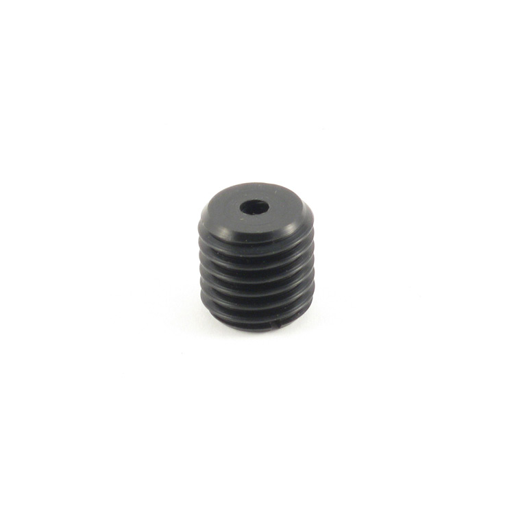

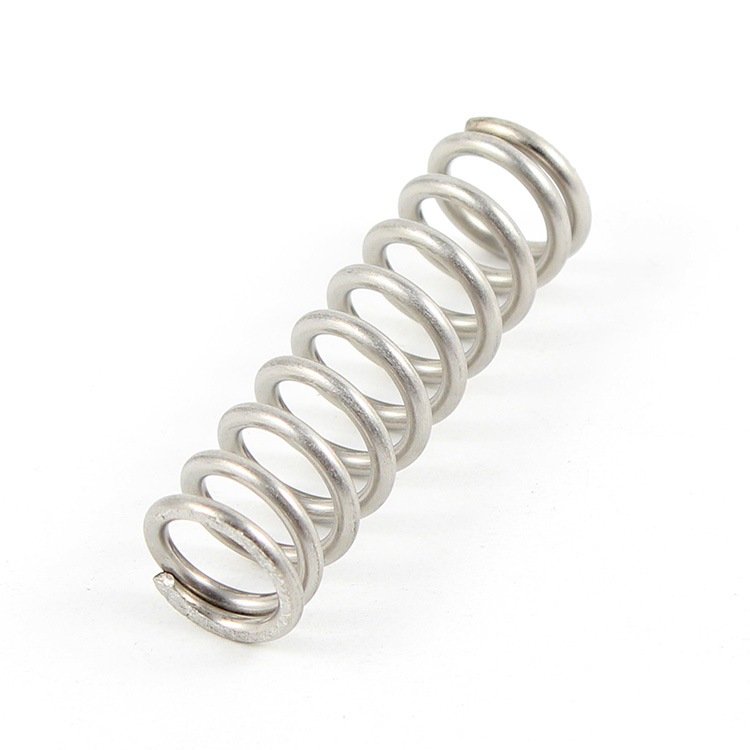

Springs and Delrin screws are still available.
10430000 SPRING RUDDER CASTING
60450000 SCREW DELRIN RUDDER
