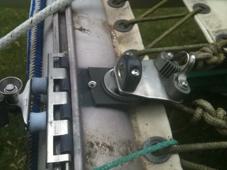

My early fathers day gift is a 85 hobie cat 16. I have downloaded the manual but looks like a copy of a copy copy thus the pics offers limited use. I have strung the main sail to the best of my ability however I have a broke piece but I have no idea what it is
If you experts see a problem with the rigging feel free instruct me proper rigging

That is a swivel pad #1162
Route the tail end of your main sheet back into the swivel jaws... eye... through the car... dead eye (mid beam on the back) and tie a stopper knot.

The cleat on the mainsheet is angled far too high. There's small screws on the sides that you can remove and adjust it lower.
The traveler cleat is bent down. Gently bend the mounting plate up slightly so you can cleat the traveler line.
And either clean or replace that nasty tramp lacing.

The swivel cleat base is broken at the rivet. I had the same thing happen when I tried to bend up the swivel. I made an emergency repair by drilling two holes in the plate through the crossbar and installing two sheet metal screws. It worked so well that I haven't replaced it. That part takes quite a lot of stress. Don't try bending the plate without removing it from the boat.

Your righting line apears to be on backwards. it should run around the front pylons and back to the rudder pins. I believe there is a picture in the current catalogue. Also a litttle bar keepers friend on the tramp will have it looking like new again. congrats on the new boat. :mrgreen:
