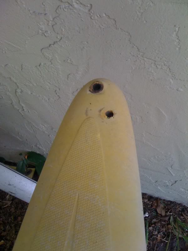

I finally got a few pictures of the rigging that I was wondering about.
First, this is the starboard bow, there were 2 bridles on each bow, each with adjusters.
http://i15.photobucket.com/albums/a362/ ... hoto17.jpg

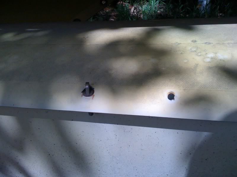

Then, there were 2 shroud anchor/adjusters on each hull..
http://i15.photobucket.com/albums/a362/ ... hoto16.jpg
Does anyone know the purpose of these extra fittings?

well you are correct... you do have 2 attachment points. From what I can tell from the pictures your shroud anchor is currently in the correct position. the Bridle should go in the forward of the 2 holes.
My 3 theories for the 2 sets of holes are:
1) the existing structure is bad and needed new points to find enough meat to hold onto (if this is the case get it fixed before you go out)
2) someone got the wrong rigging and rather than fix it they drilled new holes :roll:
3) someone was experimenting with raking the mast and was a dumb azz.
actually it appears the dumb azz title fits all of the above.

Got a couple more theories:
1) A spinnaker/hooter pole may have been used once. As the rigging options can be as numerous as the number of spi fliers out there they could have installed the spi gear on the front bow hole and the jib gear on the second, new hole further aft.
Regardless, you'll want to get the bows reinforced ASAP. Flip her over and fill the channel under the hull join/lip with glass/resin tapering out about 300mm back on each side, or at least well beyond the second hole. Add carbon if you like. Put a greased bolt or something through the bow holes first so that the fibers won't attach. When you install the tang bolt you don't have to drill through your new work.
2) They may have chosen to rig the trap lines such that the crew's was attached to the shroud chain plate and the skipper's was attached to a fitting mounted through the second, aft hole. I know because I've done just that. I saw it here on a boat named "Sciatica" several times and really liked that approach. That second hole is closer to the original compared to mine but it would work.
It took me a while to justify drilling into the hulls like that but eventually I came to believe that the advantages out numbered the one disadvantage (got pix I can send if you want). Otherwise, I cannot imagine what another hole in the hull amidships would be used for.

Thanks for the insight, and not to worry, those hulls will never see the water again. Those pics are of the hulls that are totally de-laminated. That's the one I bought for $170 for the trailer, sails, and spare parts.
