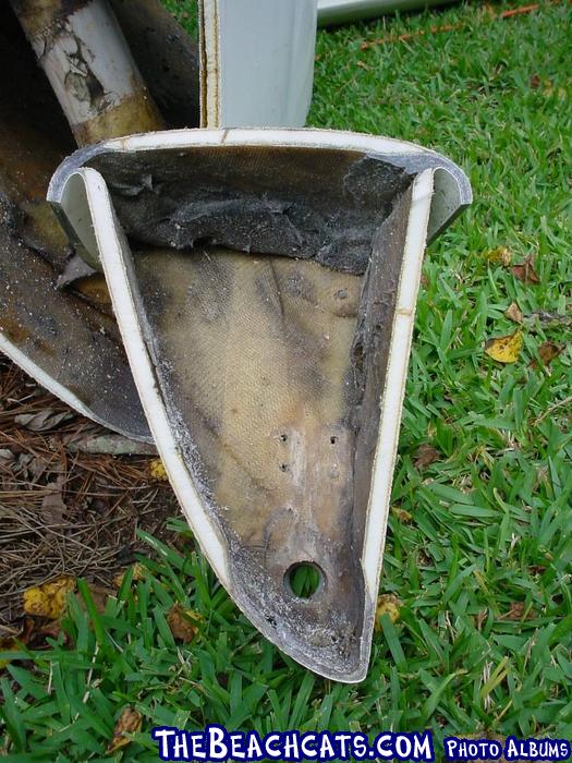

Just so I'm clear - are you talking about these - were these holes that went through the hull?
I'm trying to imagine this in cross section (referencing these pix http://www.thebeachcats.com/pictures/?g2_itemId=10731)
Jonathan

Yeah - this would be a gap in the thickened epoxy they used in the upper right corner of the hull picture below. The deck -to- hull joint. Air and water was flowing freely through those holes into the hull. Especially when the hull is in the water, under heavy load and ripping along like in the video!
