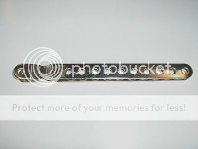

I actually don't do anything special with it other than put the d-ring in the highest hole on the adjuster when I raise the jib.
the farthest right hole in this picture is where I attach the jib:

I see what your doing, I run my jib the opposite way so that its all the way at the bottom hole of the adjuster or left in your adjuster picture.
I might try what your doing, and see how it works. no extra D rings for me though, I'd rather just get a longer forestay wire and put it between the mast tang and jib tension adjuster pulley.
My mast stands more upright because of it, It came that way (stock) and I've always run it that way because sailing on an inland lake, I want the boat to point the best I can upwind. But now I begin to wonder if that little bit of gain, if any at all, is overshadowed by a greater chance of pitchpole on a down wind beat .
