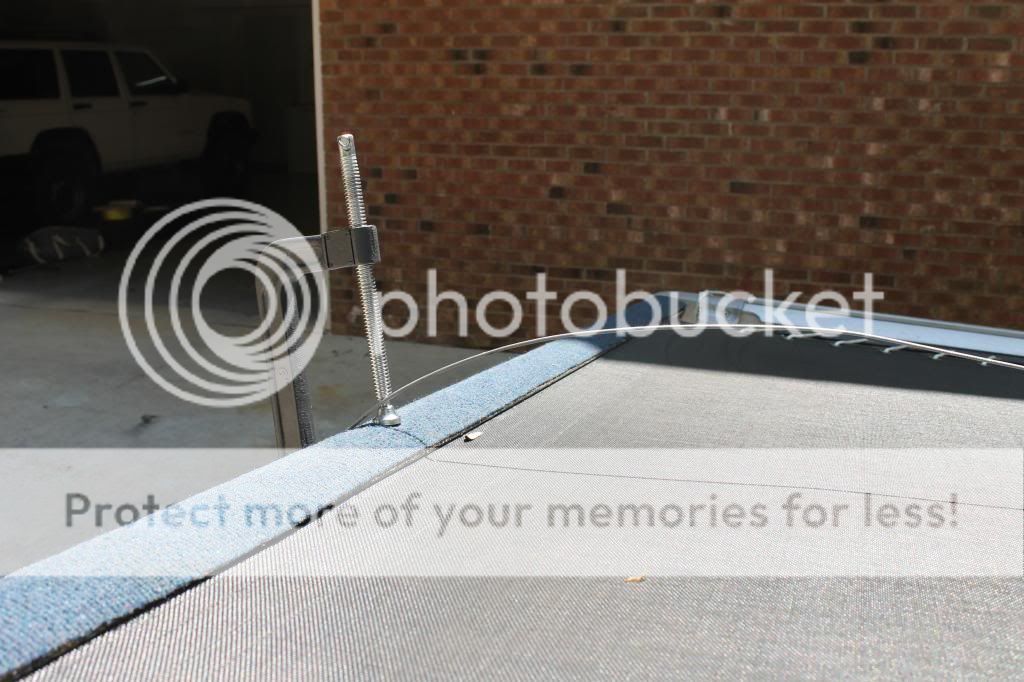

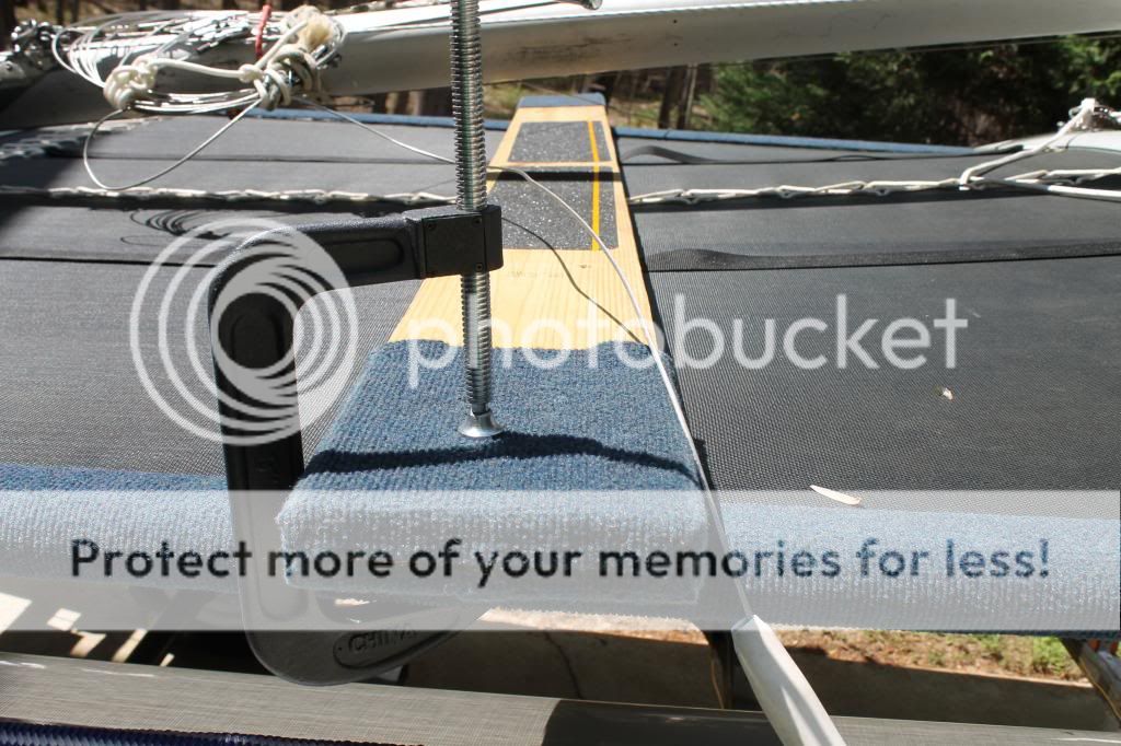

Karl, I use a board clamped to the frame for traction when I raise my mast, the clamps/edge of the board are perfect for keeping the shrouds from getting hung up, I'm sure you could just get a pair of C clamps to hold your shrouds forward
board and clamp together:
you could use a clamp this way to keep the shroud from sliding back and catching under the tramp:
